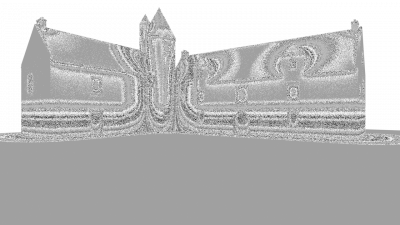

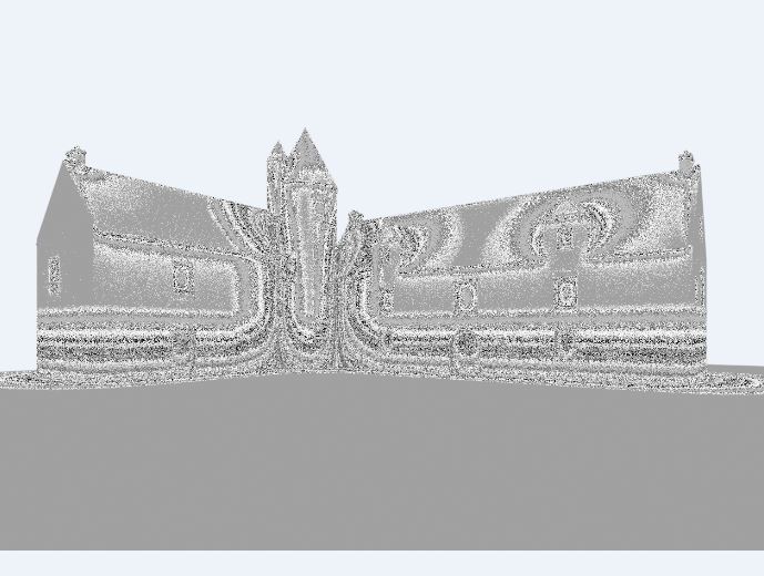

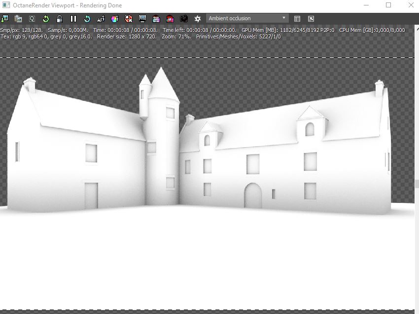

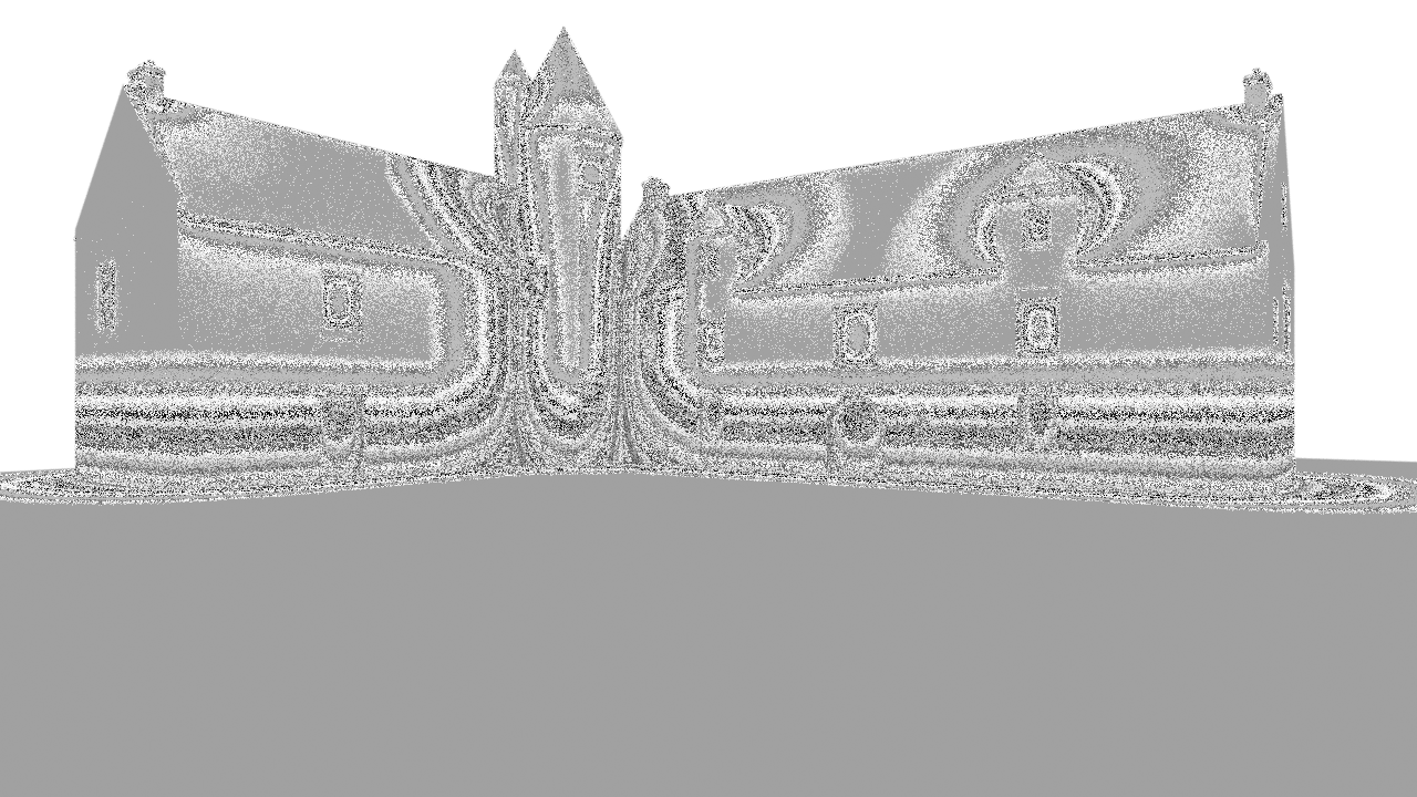

I have had a problem for some time
if I calculate the AO pass in the viewer
everything is fine, but when I save it in PNG format, the image is all damaged
same as TGA or other format with transparency, no problem in jpeg
pb in save
pb in save
no pb in viewer
no pb in viewer

pierres
Posts: 31
Joined: Fri Oct 12, 2018 8:06 pm
I don't know if it comes from octane, not at all for that matter.
I can send the .max if needed

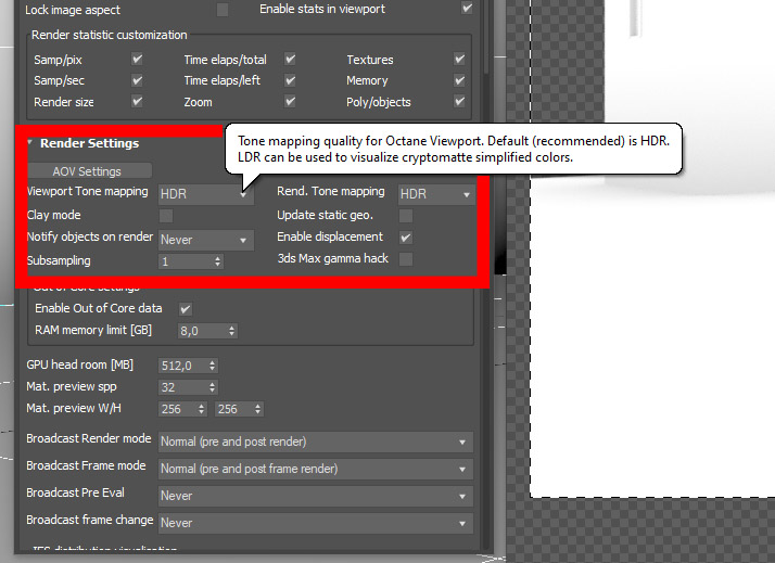

paride4331
Posts: 3989
Hi pierres,
please set Vieport tone mapping to HDR.
Regards
Paride
pierres
Posts: 31
Hooo !! thanks Paride
