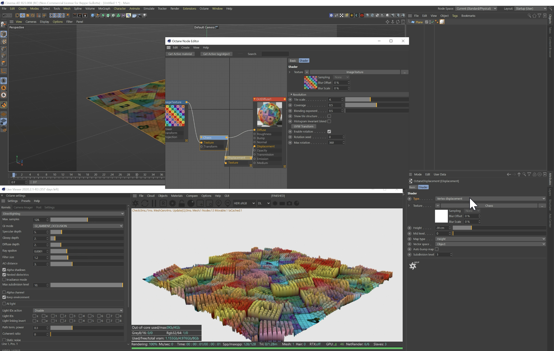

It does not work wih displacement.
3080ti
Posts: 10619
probably you are using the Displacement node in Texture mode, that does not allow any texture transformation.
You need to switch to Vertex Displacement, to make it works:
Happy GPU rendering,
ciao Beppe
ceen
Posts: 115
Joined: Wed Jun 10, 2015 9:43 pm
bepeg4d wrote:Hi,
ciao Beppe
Thank you!
