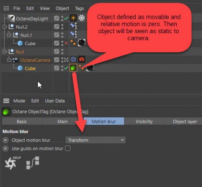

I have a problem where I have a child object of a camera gets way too much motion blur. The camera is travelling a distance, but the child object is almost not moving in relationship to the camera. So there should be hardly any motion blur.
I have tried putting an octane object tag on it, forcing it to disable blur (or all the other options). I've moved the object out of the camera and constraint it with a tag to the camera. But nothing helps.
Is there a solution to this? (oh and I don't want to turn on 'disable camera m.blur, because I do need that motion blur on the other objects in the scene)

1-Do not trust LV for motion blur without know how it works. It requires resending the scene or going back/forward in the timeline.
2-See picture.

Thanks Aoktar! It was indeed LV playing tricks on me, renders good in PV
