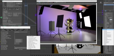

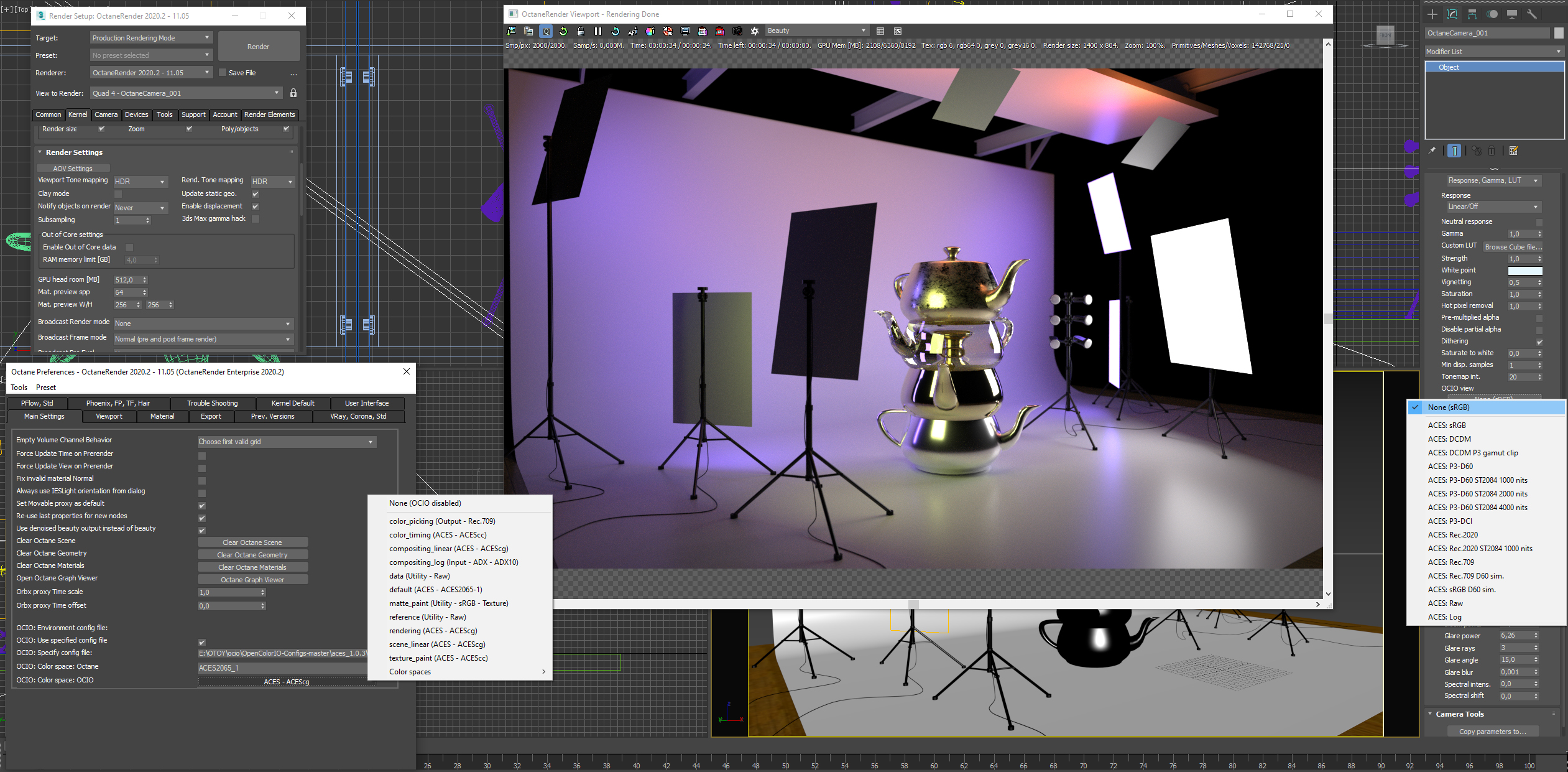

Not about what is right for me, I recommend you to read this website from Chris Brejo;
https://chrisbrejon.com/cg-cinematograp ... stem-aces/
- paride4331
- Posts: 3986
Hi samsue,
"Karu wrote:
Octane is a spectral renderer and doesn't render internally in any RGB color space (i.e. there is no working space). It can be considered to output directly in the color space chosen, be that ACEScg, ACES2065-1 or any other space available.
viewtopic.php?f=85&t=76633&p=394855&hilit=+aces#p394855
Regards
Paride
