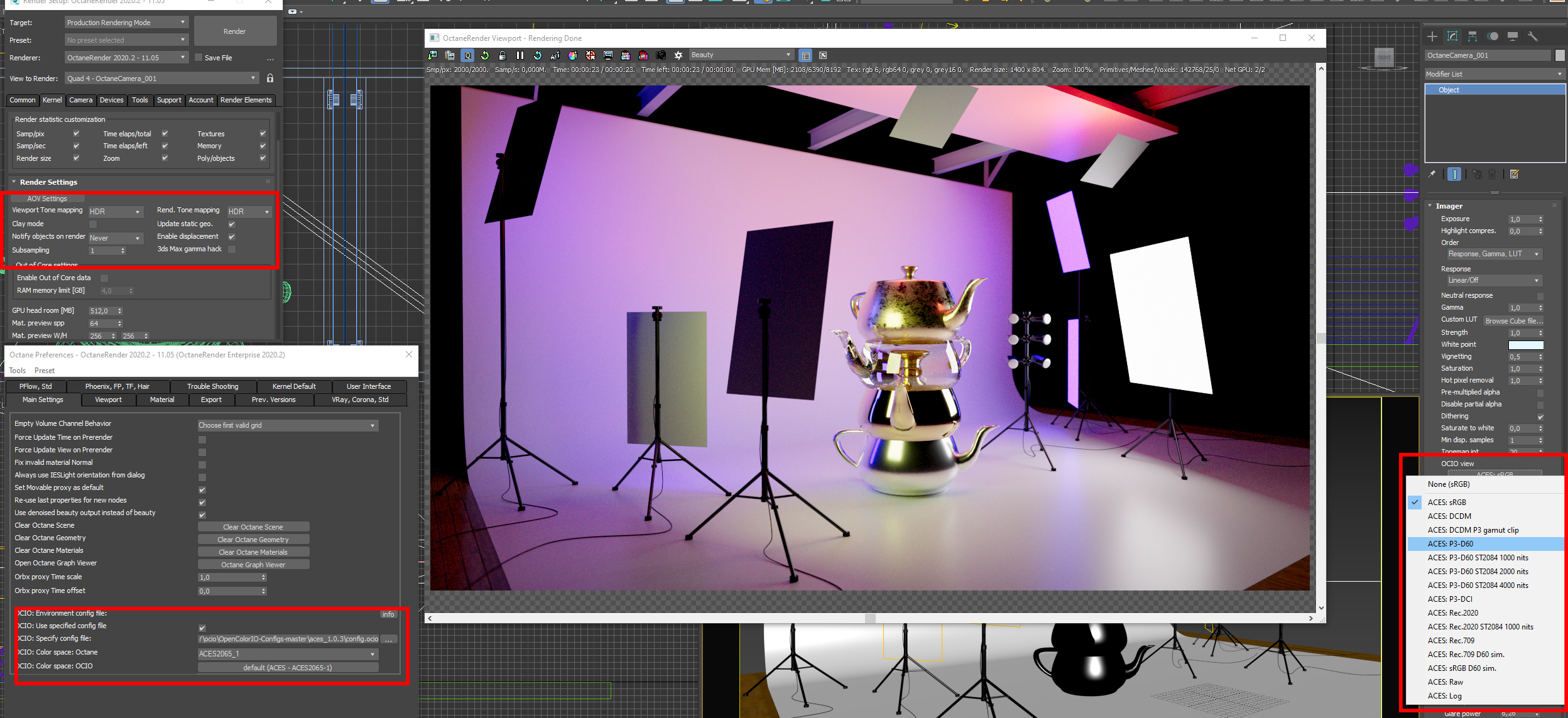

ACES ocio setting
paride4331
Posts: 3893
I hope it helps.
Regards
Paride
samsue
Posts: 393
According to the ACES academy website, you should use aces_CG for renderings. Have you tested it?
paride4331
Posts: 3893
samsue wrote:According to the ACES academy website, you should use aces_CG for renderings. Have you tested it?
Hi samsue,
Play the right way, according to your needs.
Regards
Paride
samsue
Posts: 393
Not about what is right for me, I recommend you to read this website from Chris Brejo;
https://chrisbrejon.com/cg-cinematograp ... stem-aces/
paride4331
Posts: 3893
Hi samsue,
"Karu wrote:
Octane is a spectral renderer and doesn't render internally in any RGB color space (i.e. there is no working space). It can be considered to output directly in the color space chosen, be that ACEScg, ACES2065-1 or any other space available.
viewtopic.php?f=85&t=76633&p=394855&hilit=+aces#p394855
Regards
Paride
samsue
Posts: 393
This is the kind of information we need, to make things clear.
Now it makes sense! Thanks
