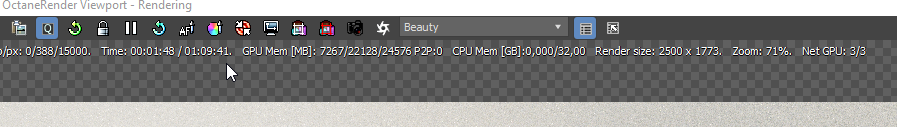

In my Workstation, I exchanged 2080 Ti which i use only for renderingfor 3090. Much faster ... Seriously it doesn't seem just 2x faster ... quite impressing.
that said....
on my render server i have 4x 2080 Ti... the vram still appears as 24gb, I thought it should be 11 because I am using the 2080 Ti also
