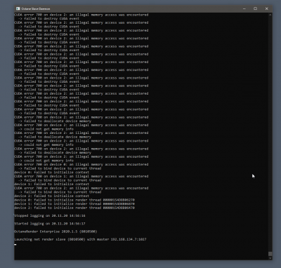

Started logging on 19.11.20 15:13:03
OctaneRender 4.05 (4050000)
device 0: failed to find a CUDA binary matching compute model 8.6
I can't render with RTX3080

Hello zhaoming,
It will work but not RTX acceleration hardware.
Should try to Update windows 10 up to at least build 1909 or 2004 and latest Nvidia "studio driver".
Regards
Paride
Regards
Paride

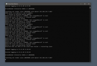

In my Workstation, I exchanged 2080 Ti which i use only for renderingfor 3090. Much faster ... Seriously it doesn't seem just 2x faster ... quite impressing.HHbomb wrote:@samsue Only "fine" or FIIIINNNNNE !!!!!?????
that said....
on my render server i have 4x 2080 Ti... the vram still appears as 24gb, I thought it should be 11 because I am using the 2080 Ti also
- paride4331
- Posts: 4001
RTX Ampere serie should work with Nvidia 456.71 "studio driver".
Regards
Paride
Regards
Paride
