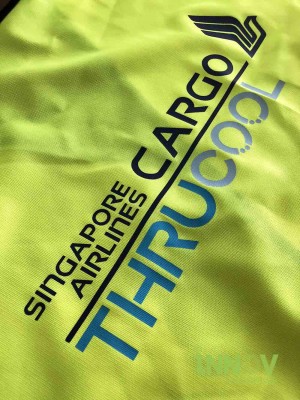

I created a t-shirt, from Marvelous Designer and imported in Cinema 4d.
But I have no idea to create the material:cotton with a silkscreen.
Intention is to create something like this: https://www.innoventerprise.com/wp-cont ... -Cargo.jpg
How should I start with this? Do I have to use Substance Painter and import it in C4d?
Or can I do this with just C4d and the octane plugin?
Thanks,
Tim
Reference image
Reference image
