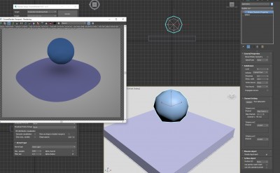

I would like to enable Subdivision for an object.
The modifier (Octane Geometry Properties) works on the whole scene.
How to make it work only on the selected object?

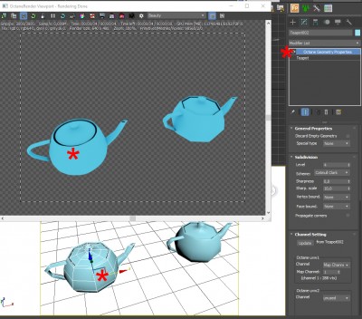

Hi pepasystem,
select you object, add "Octane Geometry properties" (modifier list) then encrease the subdivision level as you need.

Unfortunately, adding a modifier to one object affects all others in the scene.

Hi pepasystem,
maybe you instanced the objects.
Regards
Paride

No,
OGP only on sphere.

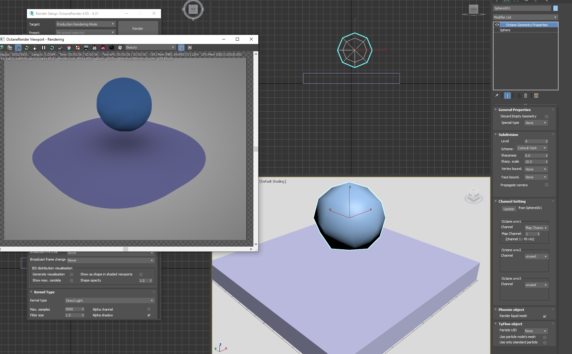

Here is the scene.

paride4331
Posts: 4001
thanks,
I can reproduce your issue.
I sent it to developers.
A work around is setting all objects "movable proxy".
Regards
