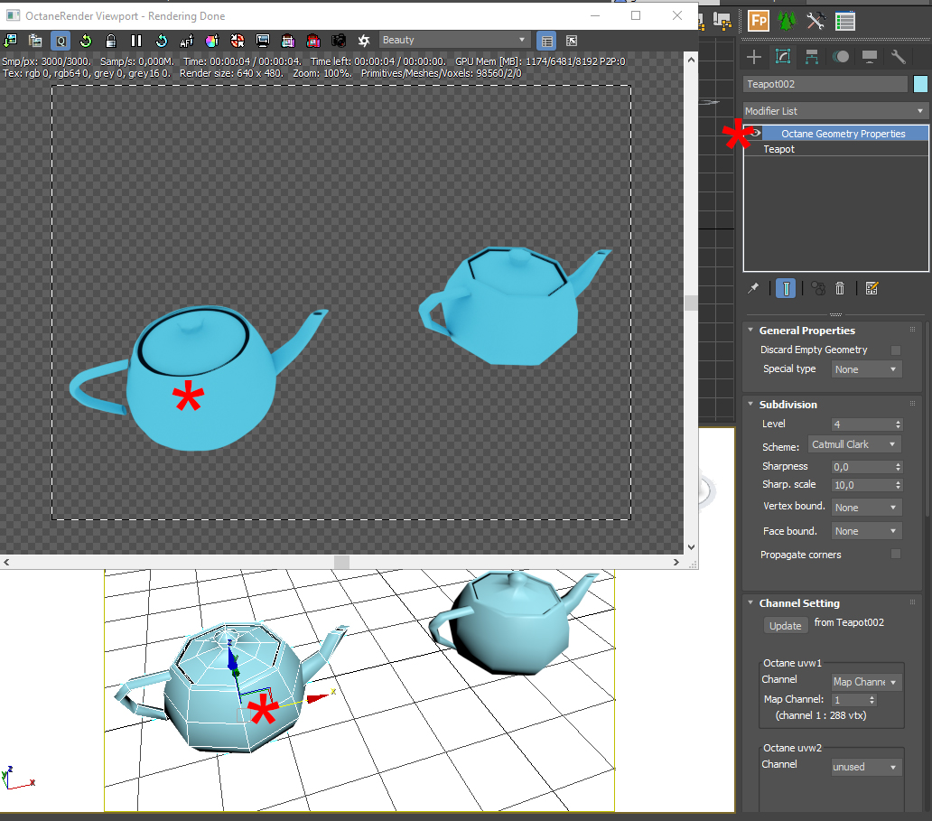

I would like to enable Subdivision for an object.
The modifier (Octane Geometry Properties) works on the whole scene.
How to make it work only on the selected object?

Hi pepasystem,
select you object, add "Octane Geometry properties" (modifier list) then encrease the subdivision level as you need.

Thanks for the answer.
Unfortunately, adding a modifier to one object affects all others in the scene.

thanks,
I can reproduce your issue.
I sent it to developers.
A work around is setting all objects "movable proxy".
