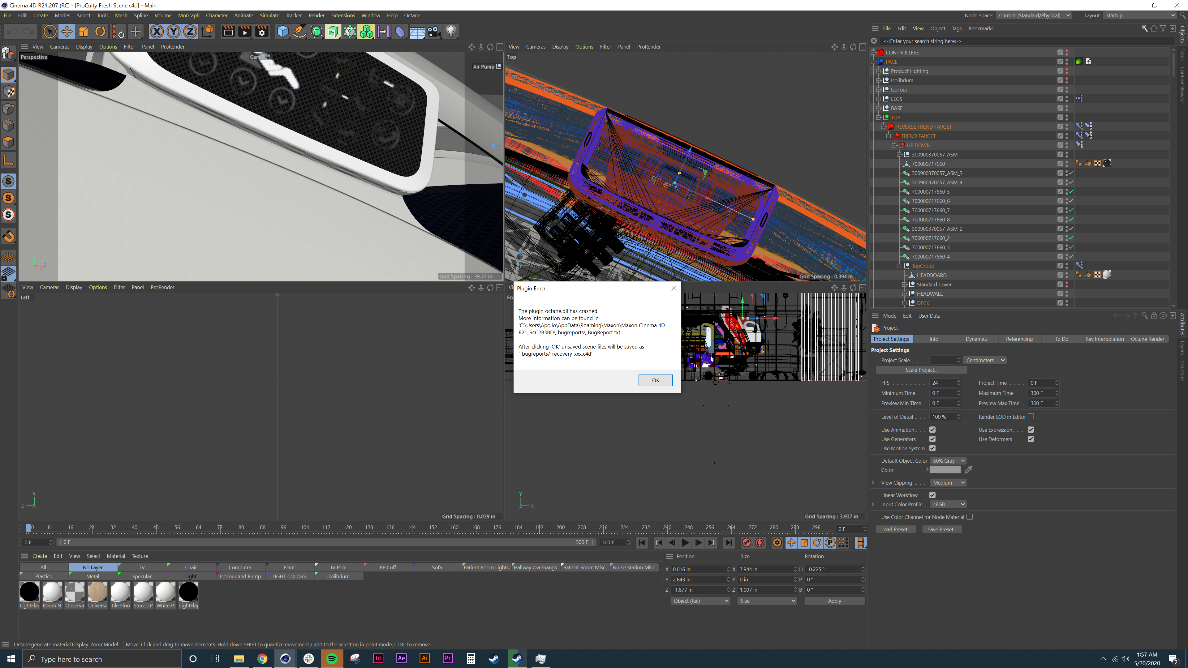

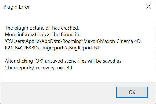

H. When I try opening this scene, it appears to be generating octane materials and then crashes. Note - I don't even have live viewer open when this happens. Unfortunately, I can't share a sample scene. When I hide certain objects from my viewport the issue goes away, but as soon as I make them visible again the crash returns.
Generating Materials Crash

before sending the scene to GPU, please go to c4doctane settings/Other panel, and press the Empty texCache button.
In 2020.1-R4 you can find the Empty TexCache command also in Live VIew menu Materials:
ciao Beppe
ciao Beppe
