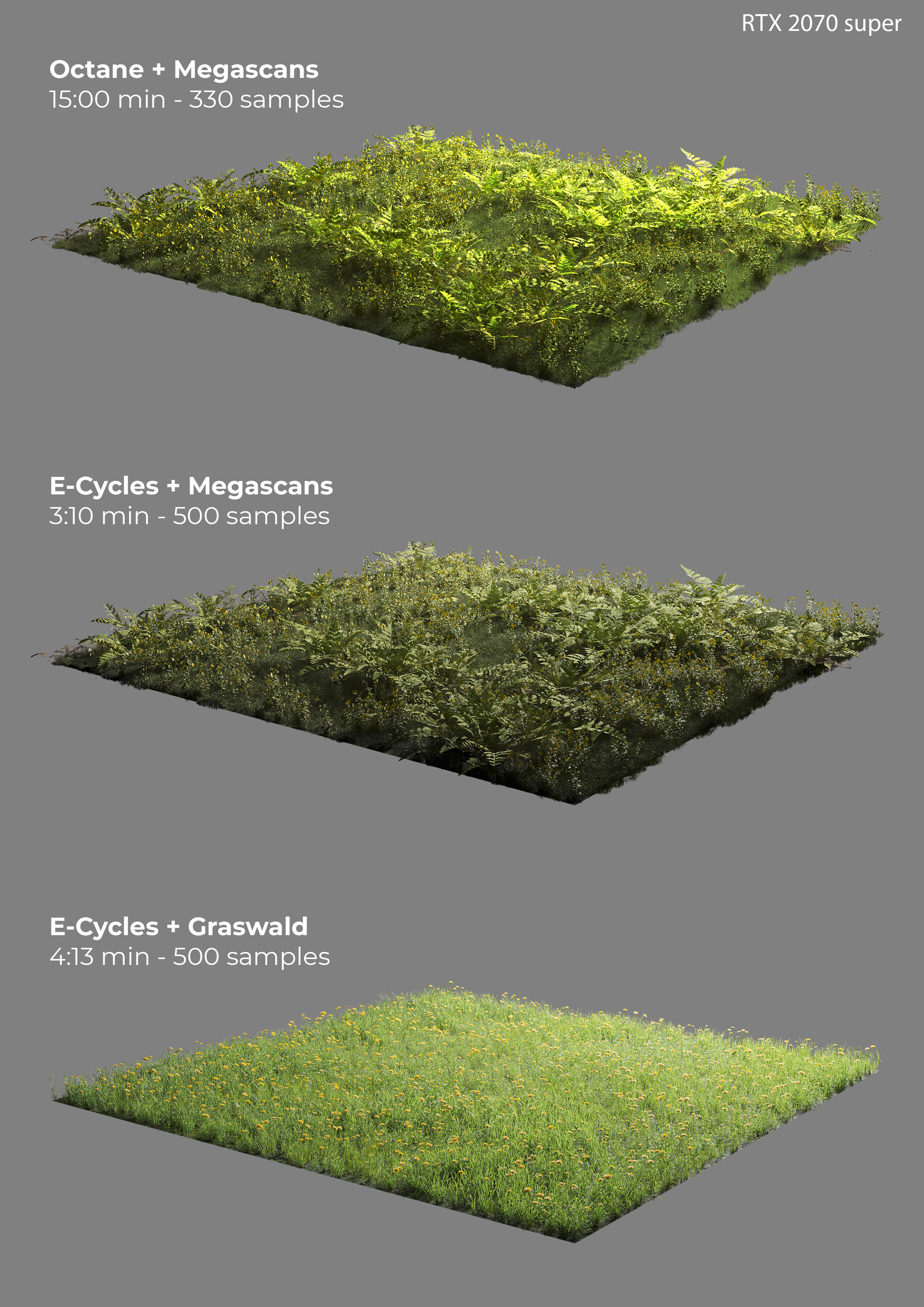

i have try to do a grass field with megascans 3d plants in octane and Blender 2.8.... but somehow it's very slow.
I compared it to e-cycles and graswald. both are much faster even if the result is not necessarily the best.
i have used the "scatter plugin" from blendermarket: https://blendermarket.com/products/scatter
3:10min to 15:00min is a huge diffrent
Is there a solution to speed up the rendertime in octane?

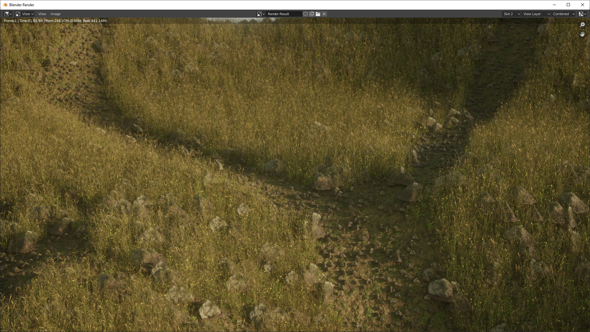

I've rendered this in less than 1 minute and 6 seconds (500 samples, no denoiser used - 2 RTX 2080 Ti cards):
