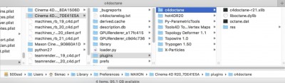

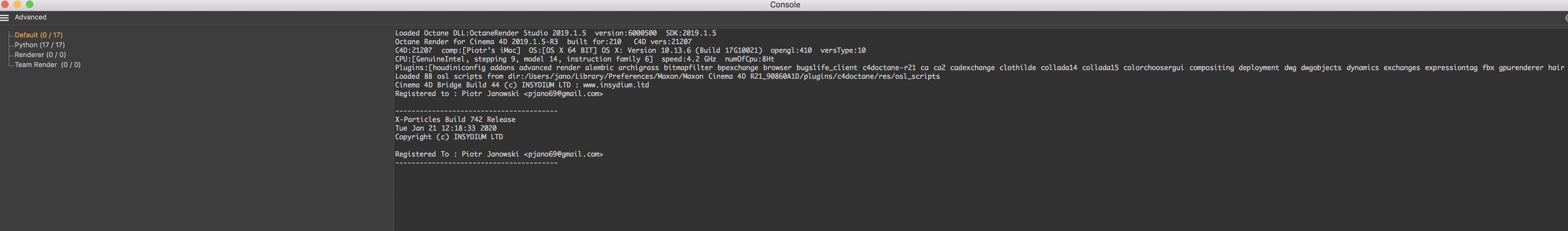

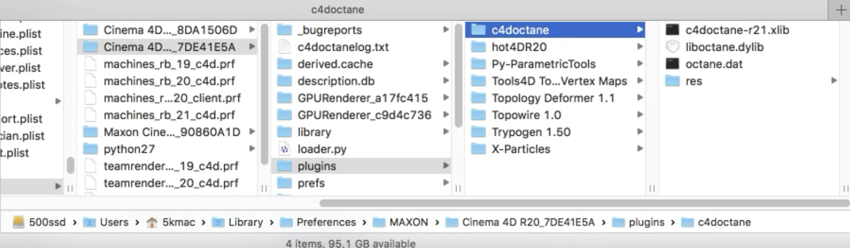

Posts: 10646
Hi Piotr,
from what you have written, everything seems in order.
Please, go to c4d menu Extensions Console, (Shift+F10), and share a complete screenshot of the panel, thanks.
Please, also share a screenshot like this one:

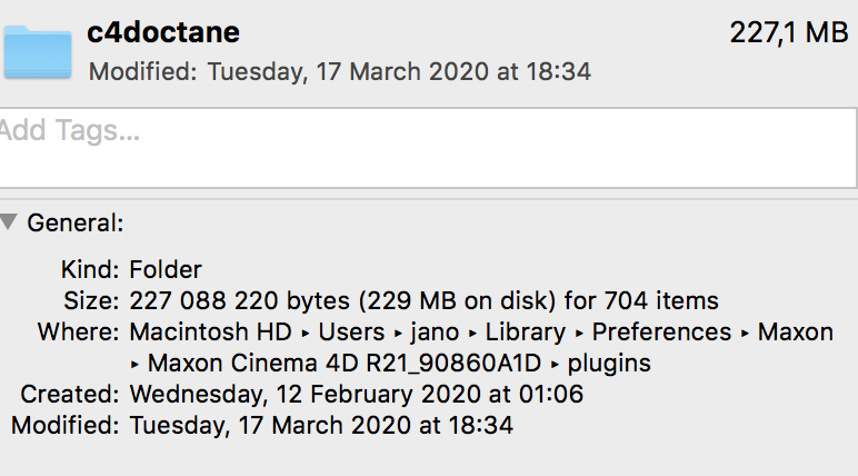

Hi!
Thank You for the suggestion.
Here are the screenshots
Screen Shot 2020-03-20 at 13.14.01.png (28.44 KiB) Viewed 2644 times
