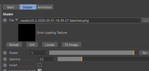

Well basically when I try to save a material in live DB and then bring it back into a new scene I get an "error loading texture" with any texture.
I'm currently using XB3-R2 but it's the same with whichever version of the Octane C4D plugin I use. I can't find a solution to this, it just doesn't read the orginal file path back to the image.
Any ideas would be most welcome.
Posts: 16067
Location: Türkiye
What's your scene path and did you download after saving the scene? Having "assets/...." means that you downloaded material on untitled scene without project path

aoktar wrote:What's your scene path and did you download after saving the scene? Having "assets/...." means that you downloaded material on untitled scene without project path
OK so had another look this morning. Yes if I save the scene and then load in the textures it does indeed load in the material's images, it however completely misses out any displacement nodes. They no longer exist in the imported material.
