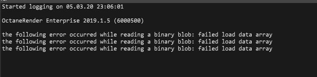

cinema 4d r19, octane 2019.1.5 (and it was same issue in last 3 stable releases) the current driver is 442.19 (but as I already said the problem has existed for about a year, so there were different versions of drivers) right now I'm trying to fix the project from crashes, I can show it on Skype, or in any messenger where you can show the screen. I apply what is written in the octane log during an error.
is this enough or more information is needed? I will provide everything you need

c4doctanelog.txt
(3.18 KiB) Downloaded 240 times
