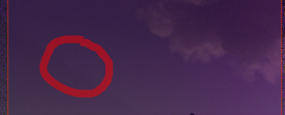

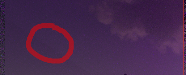

Hello guys,
Does anyone knows if there a solution to this particular problem? Basically i have an octane fog volume in my scene and a second one which is a vdb.
As you can see in the picture i can see the edges of the vdb volume. Is there any fix?

Thanks for the reply!
Tried it and didn't had any luck unfortunately :(
I did some tries and used the same values here and there but it didn't go away.

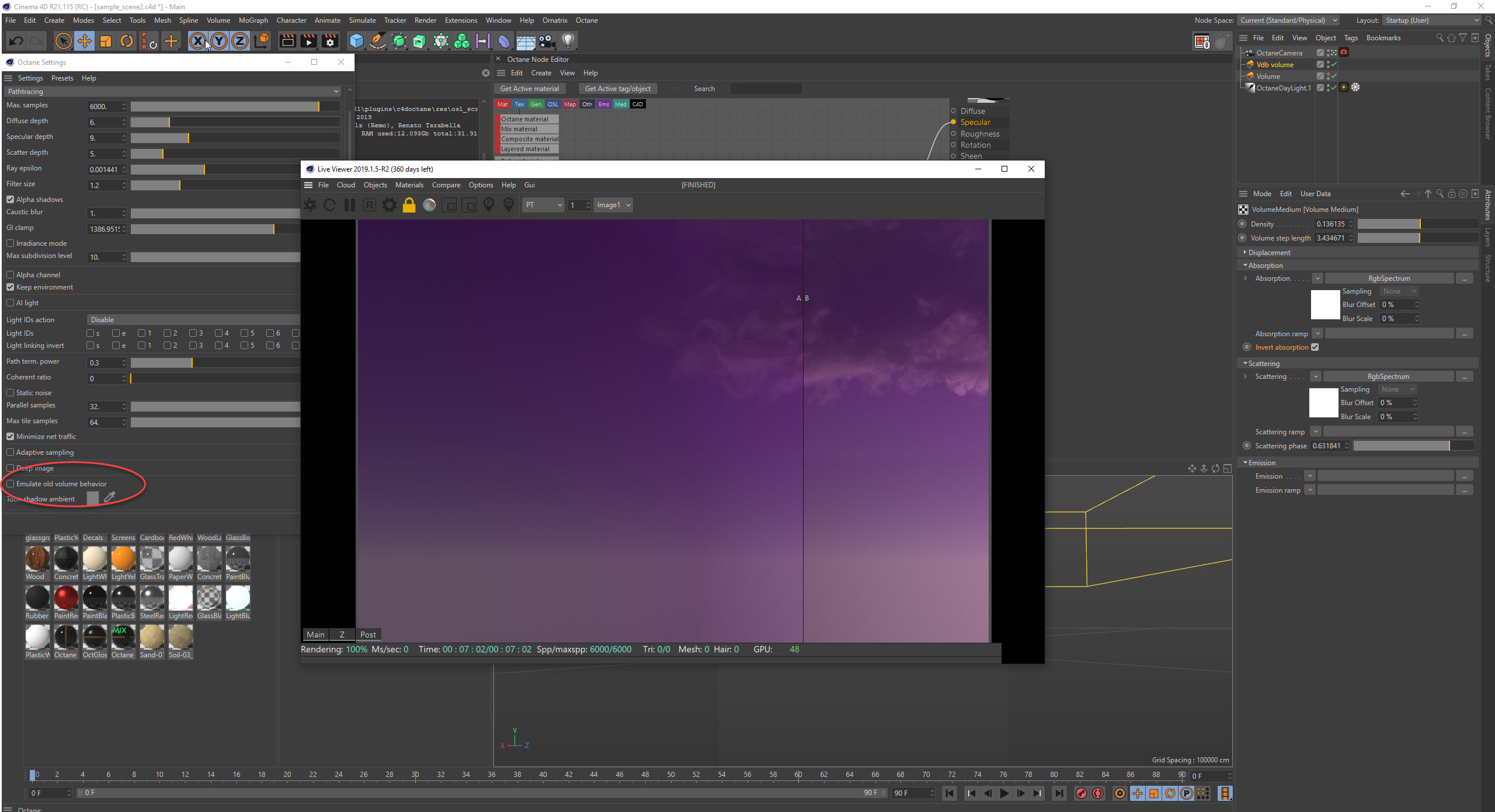

Try this parameter, you need to re-tweak the mediums. Because appearance will change after this.

aoktar wrote:Try this parameter, you need to re-tweak the mediums. Because appearance will change after this.
Worked like a charm dude, thank you so much for this!
