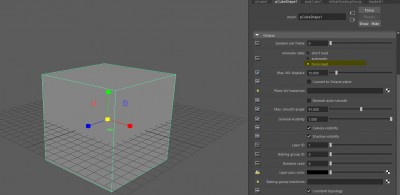

when using animated object , you have to specify a full scene reload in the object octane parameter :
but for the moment i have to select EVERY animated poly in my scene to specify this, which is quite ineficient.

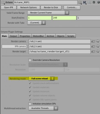

In houdini render settings you have this global parameter , that you set and it works nicely without having to select every object, is there something similar in Maya ?

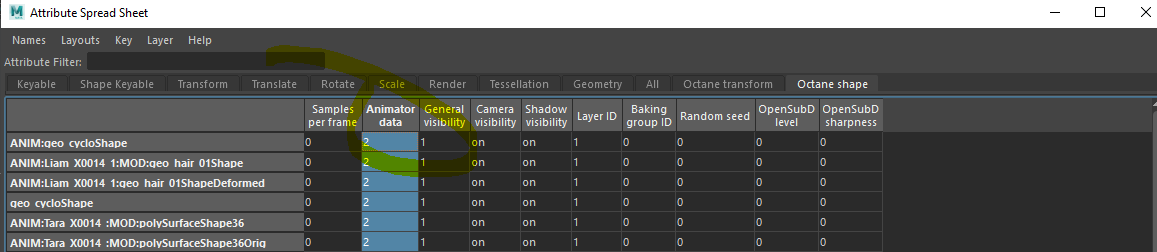

The answer is no , the easiest way is to select all object and set the value with the attribute spreadsheat for each object or to mel script all the scene.
