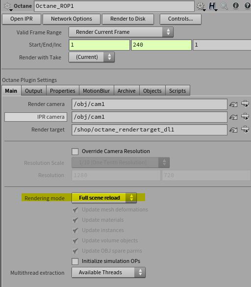

when using animated object , you have to specify a full scene reload in the object octane parameter :
but for the moment i have to select EVERY animated poly in my scene to specify this, which is quite ineficient.
i was wondering if there is a way to do this globally in the render settings directly.
In houdini render settings you have this global parameter , that you set and it works nicely without having to select every object, is there something similar in Maya ?

The answer is no , the easiest way is to select all object and set the value with the attribute spreadsheat for each object or to mel script all the scene.
I find this quite clunky cause each time you update a rig you have to remember to set the attribute again, which you often forget to do in the delivery rush.
