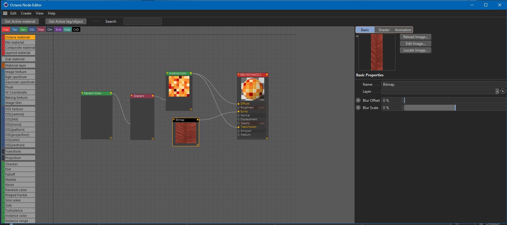

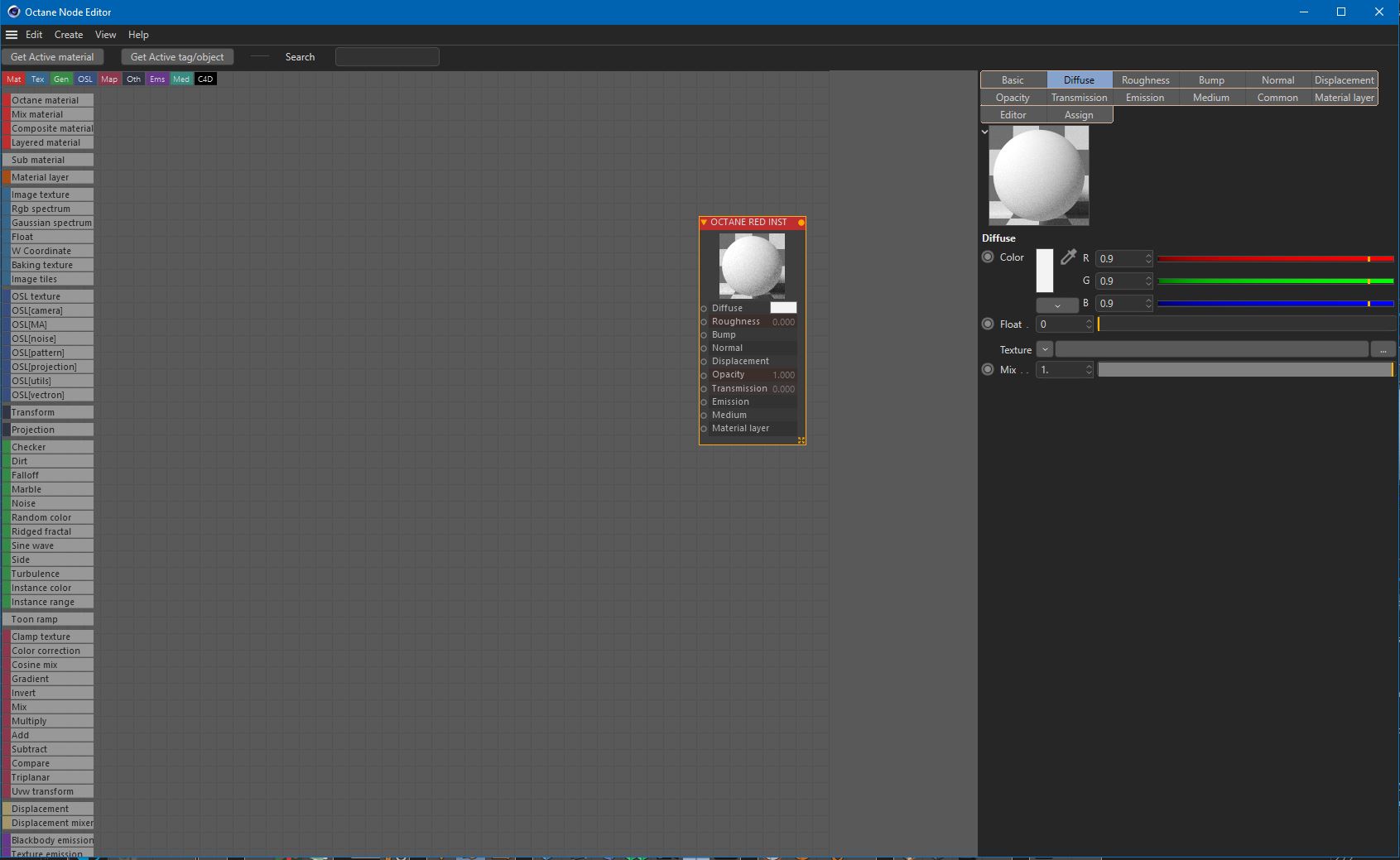

I'm working on scene and am trying to save a material just the way I have set up.
I can get it to save in the LocalDB no problem but never with any of the nodes. I have followed everything I can from posts to the manual being sure to save the scenes first following the instructions step-by-step.
Here is a simple example. The first picture always imports into a new scene as the second:

Have you tried to import the saved material in an already saved scene, instead on a new scene?

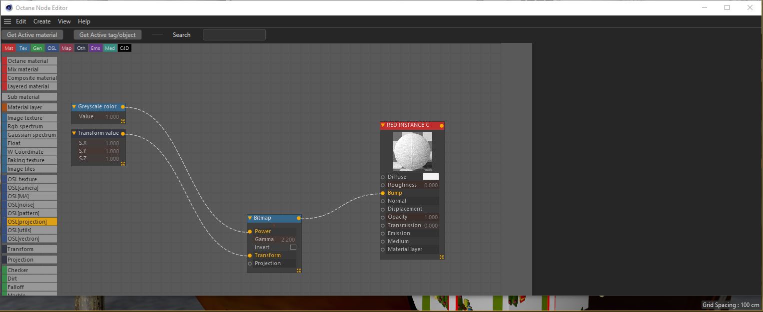

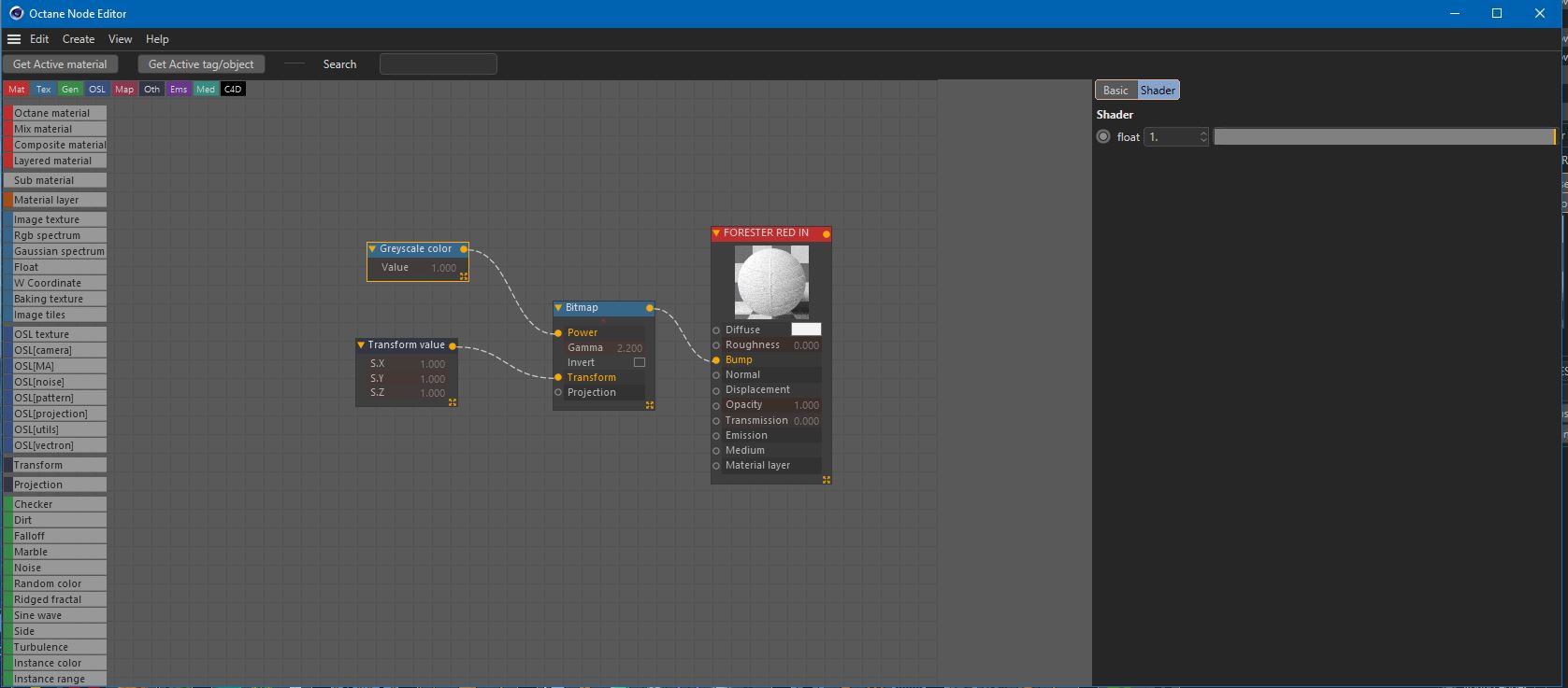

Yep, just tried it. It seems to be dumping the diffuse info. Look at the new example, it's from a Forester scene. It drops the diffuse and adds nodes to the missing bitmap (shouldn't be missing because I used one in the text folder.)
Odd thing is the inbuilt C4D "save material presets" works, so I can just use it—the opposite of what the Octane manual says. I just like using the LocalDB because I know where my materials are being saved.

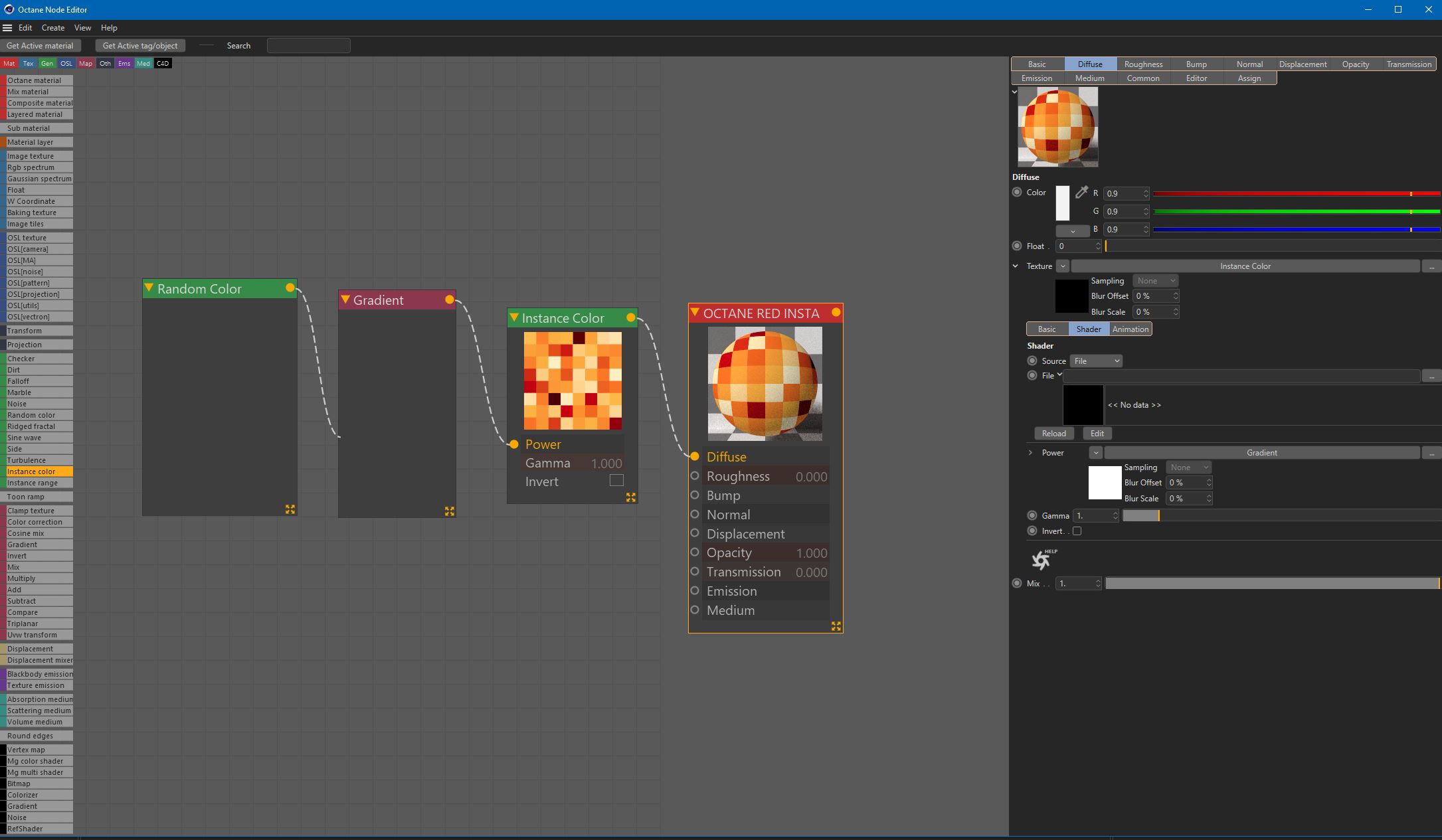

1st pic- original material, 2nd - imported into saved scene, 3rd sample what I'm doing with the instance color

Here's the actual Red Instance color reimported (It's identical to the other one though. I picked the wrong picture.)

Okay, but that doesn't explain the first two pictures in the top post. Those are four Octane nodes—Random Color, Gradient, Instance color and Octane material. Nothing else.
Are you saying that won't save into the LocalDB either? Just trying to understand.
Posts: 16068
Location: Türkiye
BCres wrote:Okay, but that doesn't explain the first two pictures in the top post. Those are four Octane nodes—Random Color, Gradient, Instance color and Octane material. Nothing else.
InstanceColor is ignored in this example. Seems like an overlooked node on import
