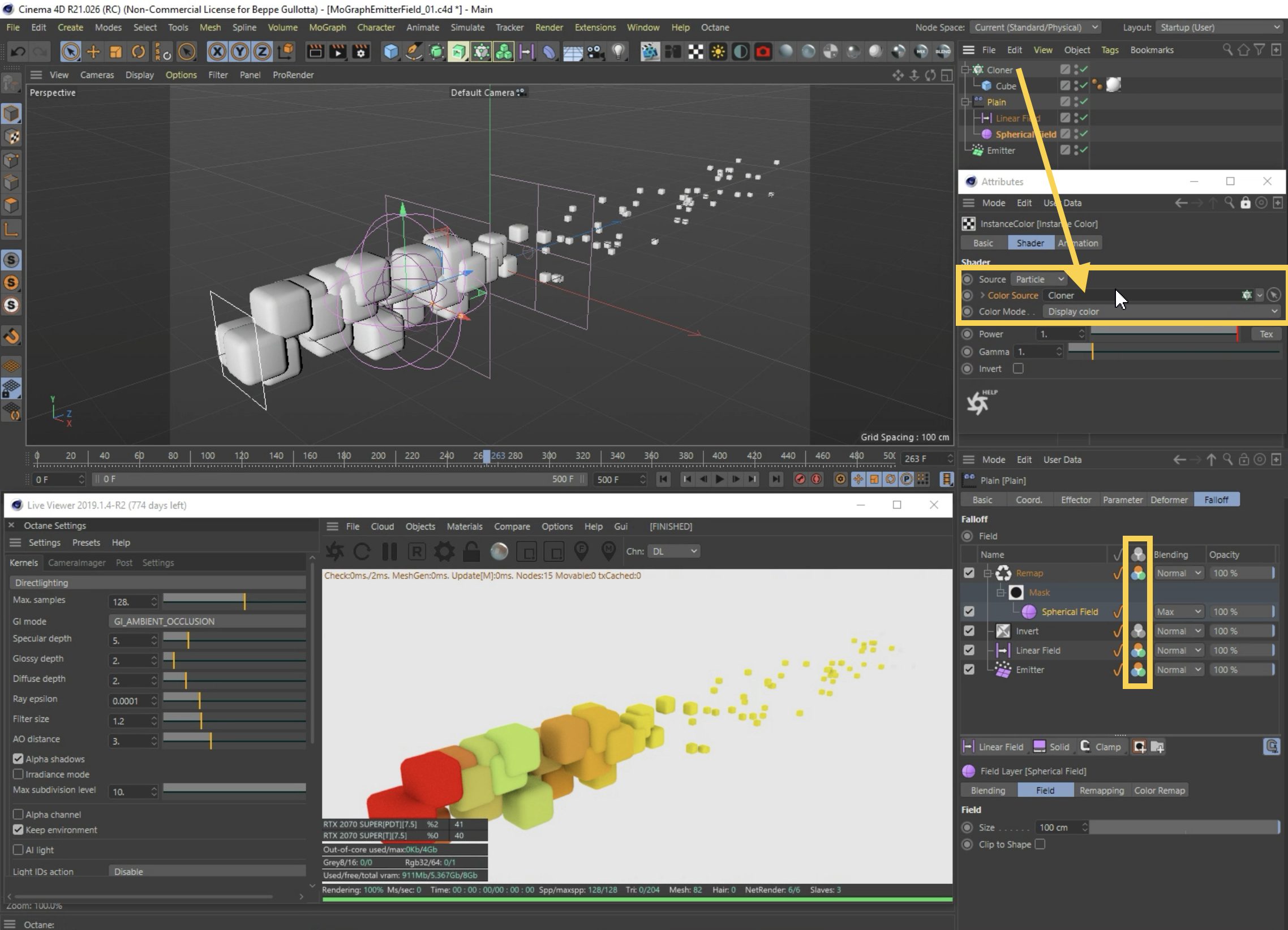

you can use several fields for coloring the instances/particles, also with Gradients, but please, don’t use the c4d Color Shader node, that works only in Instance mode, and use the Octane Instance Color node instead, that works in Render Instance mode. ciao Beppe

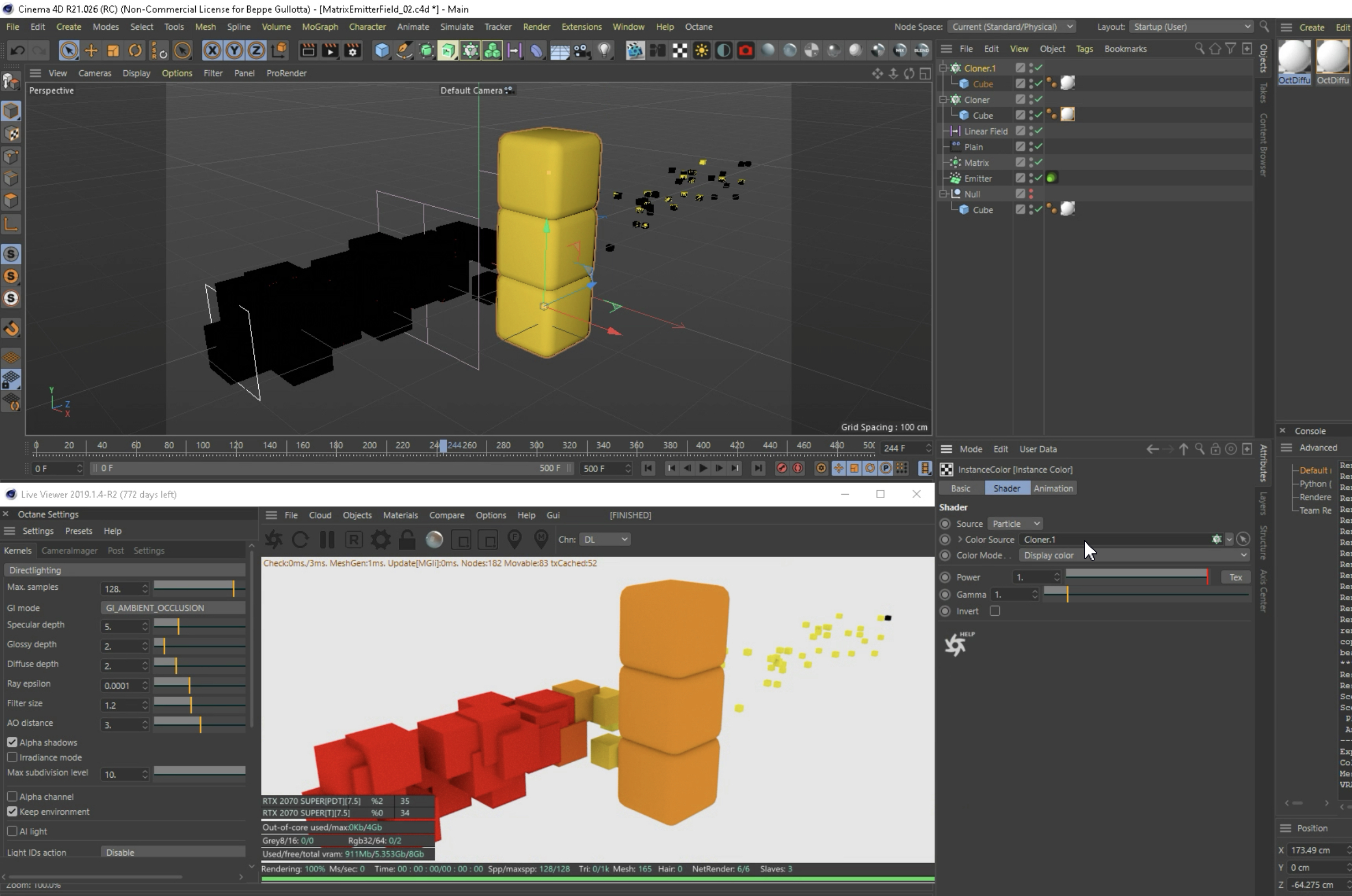

thank you very much for your answer. This is great for one cloner. The problem is right now i have several clone object that i control with one plain object and also color with fields and as far as i see there I can only add one object right? Is there any chance to apply one material to all clone objects and color it with the field?
With more than a cloner, just duplicate the Instance Color material, and assign the proper cloner in the Color Source field:
