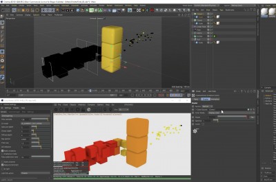

you can use several fields for coloring the instances/particles, also with Gradients, but please, don’t use the c4d Color Shader node, that works only in Instance mode, and use the Octane Instance Color node instead, that works in Render Instance mode.

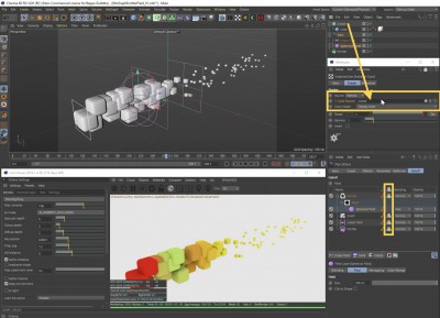

With more than a cloner, just duplicate the Instance Color material, and assign the proper cloner in the Color Source field:
