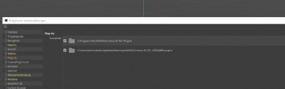

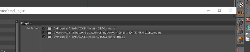

What's install path for plugin?
useruser
Posts: 142
Joined: Wed Jun 02, 2010 9:37 pm
C:\Program Files\MAXON\Cinema 4D R20\plugins\c4doctane

Posts: 16068
Location: Türkiye
Why do you show R20 version? You say R21 is not working..

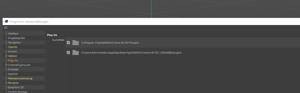

useruser
Posts: 142
sorry
that was the wrong screenshot
this is the right one:
the oc-plugin is installed in the first directory. but no matter which one i use: the result is all the same.
hangs on startup

Posts: 10536
Please, change the name of the folder from Plugins to plugins, and install only a copy of c4doctane folder, removing in it the unnecessary .cdl64/.xdl64 files not related to R21.
