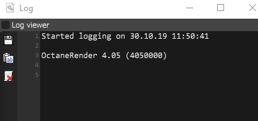

When I reload that project the Octane log has NO information other that when it started (see attached).
