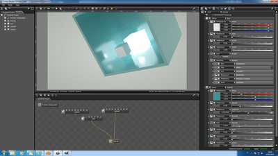

I was playing a little with lights and I found a problem assigning the same emitting material to a different object (see pictures).
In the first picture I link the inner front cube to an emitting material but nothing happens. The same material applied to the inner back cube works (picture 2).

This one no
This one no
This cube shines
This cube shines

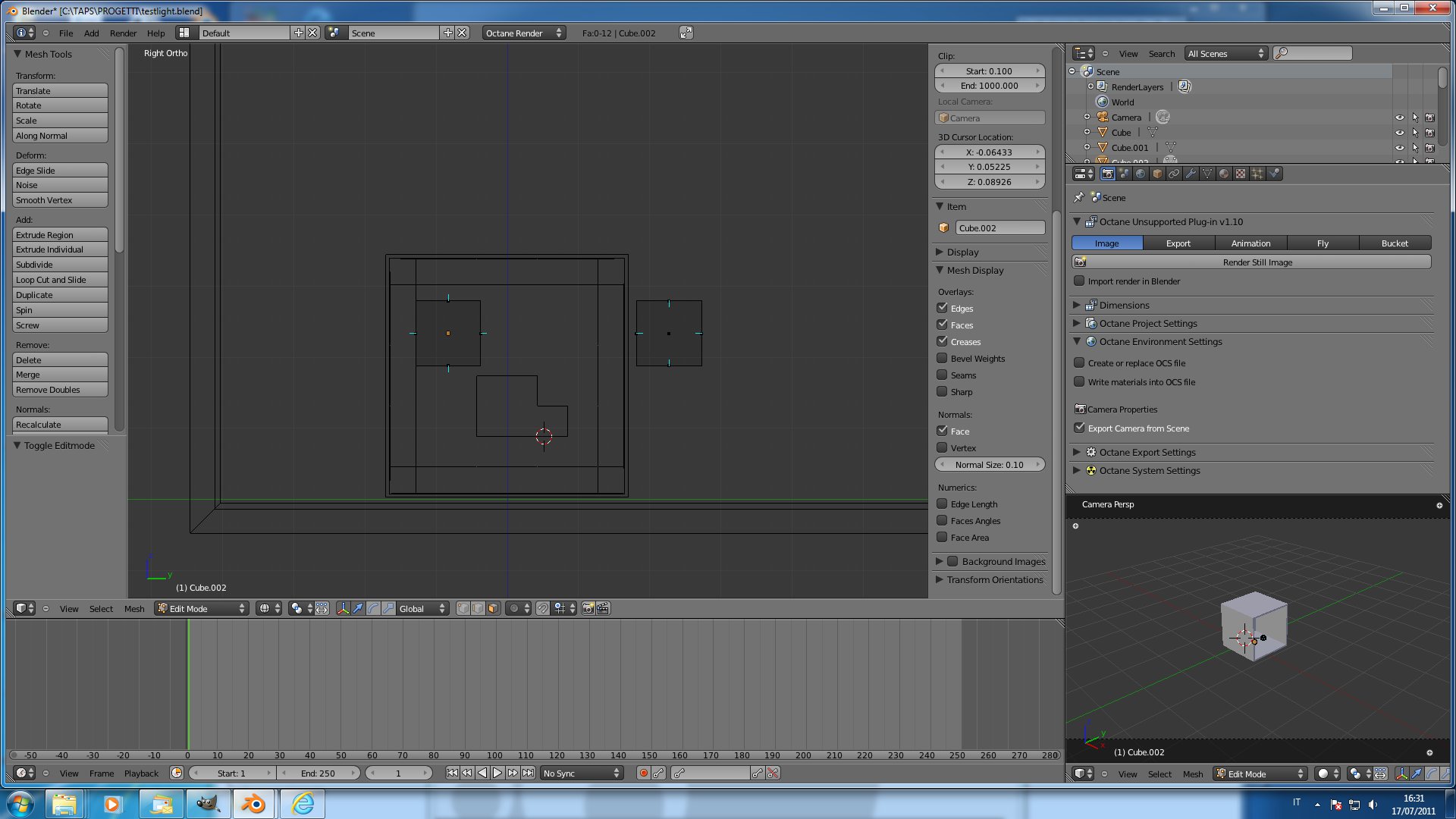

Normals?

I guess, Steveps3 is right: The normals of the front cube probably point inwards and with that the light is emitted into the cube where you can't see it.

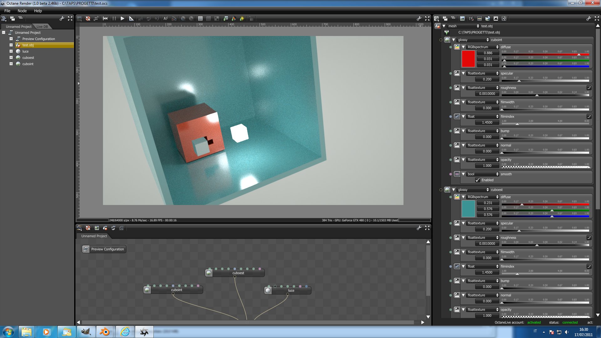

Thanks for the help... normals matter but in a strange way.
The normals were ok but when I tested them pointing inwards well... see the pictures... the wrong direction works...
Am I doing some stupid error ?
The "wrong" normals work...
