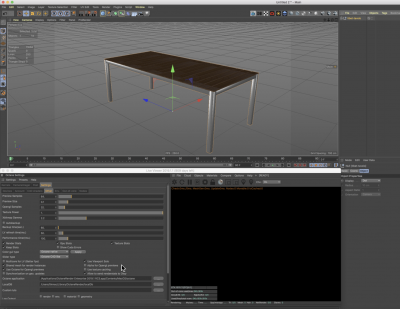

This is happening because Live View is not active, and this is why I had never seen this behavior.
Please, go to c4doctane settings/Others, and disable the Alpha for OpenGL previews option:
