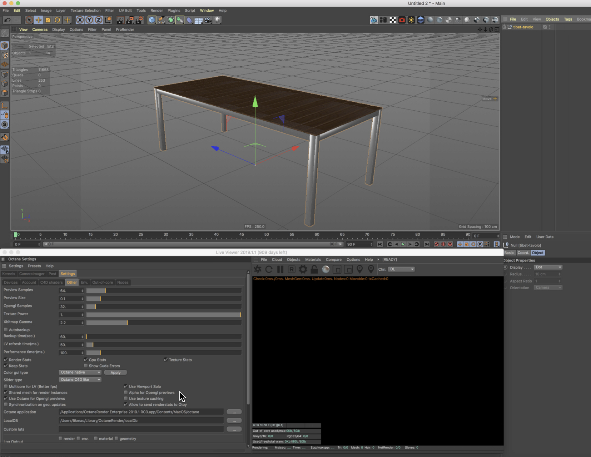

see screen capture. this is happening only when copy and pasting from more complex scenes, not from single objects scenes or with boxes etc.

Hi Markus,
thanks, now it is more clear.
This is happening because Live View is not active, and this is why I had never seen this behavior.
Please, go to c4doctane settings/Others, and disable the Alpha for OpenGL previews option: ciao Beppe
great finding, grazie mille!
