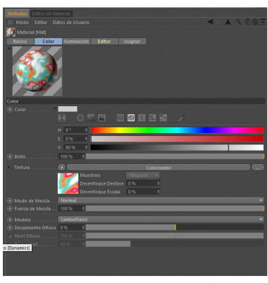

Hey everyone! I´m a noob who would be interested in getting this effect.

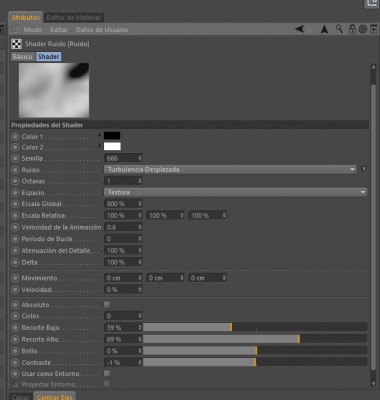

I have created a c4d material, in the color channel I add a colorized texture, inside this I add another texture of noise and I give it animation speed.

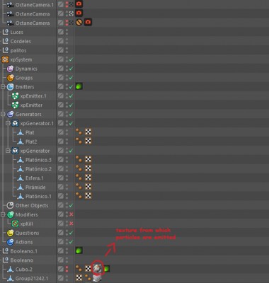

Then I apply this texture to the Xp emitter so that it emits from it. The problem comes when I apply a Xp generator with different objects linked to the emitter. The texture is not shown.
If anyone has any idea how to do it ?
(Octane Version 3.08/Xparticles build 4.0. 0535)
Thanks!

Have you try with V4 and read C4D manual for InstanceColor?

Thank you very much aoktar!! with the update to V4 and INSTANCE COLOR from x-partIcles emItter I got it.
Thanks again!

Great! Glad you did it.DamnNation wrote:Thank you very much aoktar!! with the update to V4 and INSTANCE COLOR from x-partIcles emItter I got it.
Thanks again!
