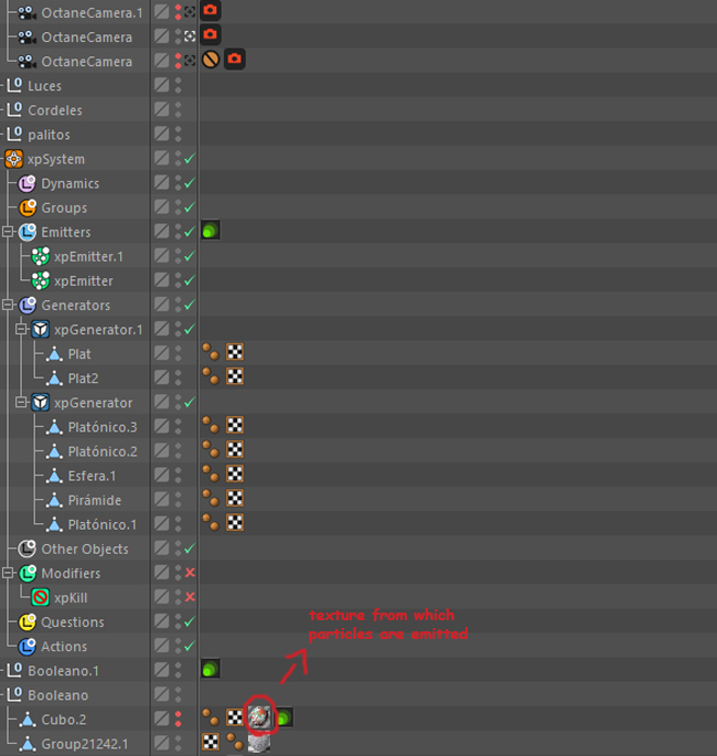

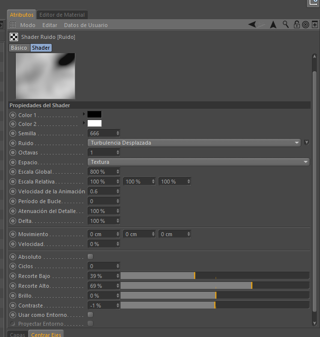

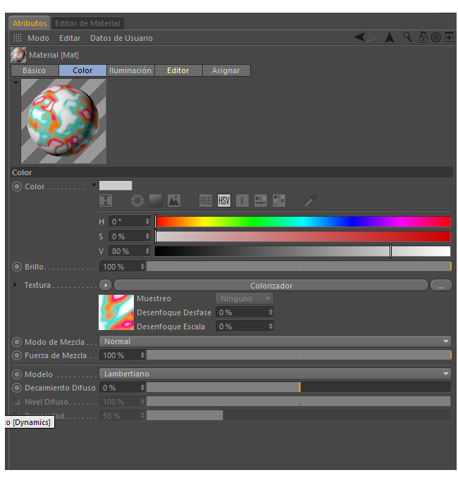

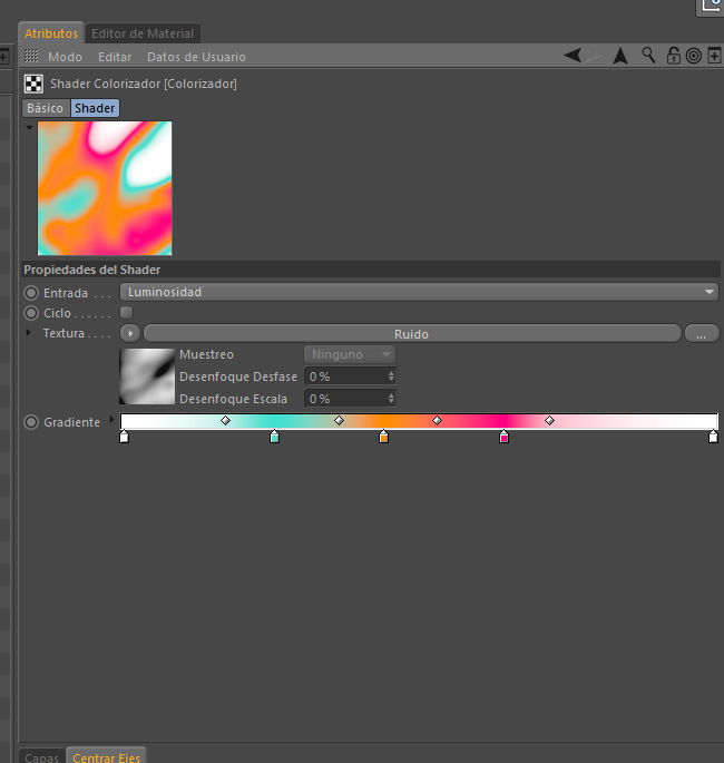

Hey everyone! I´m a noob who would be interested in getting this effect. I have created a c4d material, in the color channel I add a colorized texture, inside this I add another texture of noise and I give it animation speed.
Then I apply this texture to the Xp emitter so that it emits from it. The problem comes when I apply a Xp generator with different objects linked to the emitter. The texture is not shown.
If anyone has any idea how to do it ?
