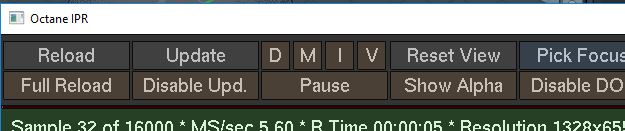

3) What is the IPR update mode configuration? Check the attached image. There are four buttons "D", "M", "I" and "V". If enabled that means that the plugin updates the full mesh of all the objects (the "D" update deformations option), all the scene materials (the "M" update materials option), all the instancers at point level (the "I" update instancers option) and all the volume objects (the "V" update volumes option). Can you please check what happens if you disable these four buttons? And if you enable the "Disable Upd." button.

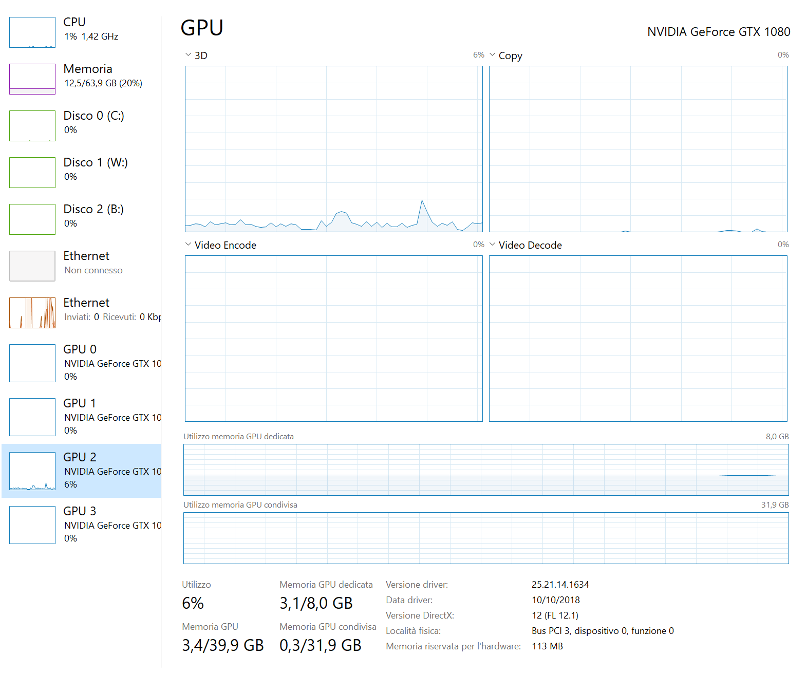

I have a question about the disable GPU: it only concerns the IPR or also the batch render? I've started a batch render and if I see the task manager it seem that only a GPU work... I attach a screenshot of my task manager during the render.

Luther76 wrote:I have a question about the disable GPU: it only concerns the IPR or also the batch render? I've started a batch render and if I see the task manager it seem that only a GPU work... I attach a screenshot of my task manager during the render.
The Windows task manager is not a good tool to measure the GPUs performance while rendering, but in any case, you must select one of the "Compute" modes in the graph drop down menu to at least see something related to the CUDA computing process.
