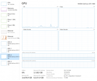

I have a question about the disable GPU: it only concerns the IPR or also the batch render? I've started a batch render and if I see the task manager it seem that only a GPU work... I attach a screenshot of my task manager during the render.

The Windows task manager is not a good tool to measure the GPUs performance while rendering, but in any case, you must select one of the "Compute" modes in the graph drop down menu to at least see something related to the CUDA computing process.Luther76 wrote:I have a question about the disable GPU: it only concerns the IPR or also the batch render? I've started a batch render and if I see the task manager it seem that only a GPU work... I attach a screenshot of my task manager during the render.
