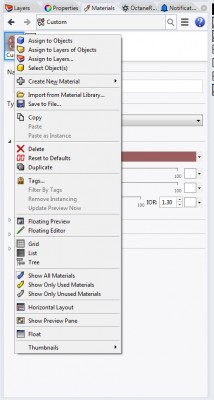

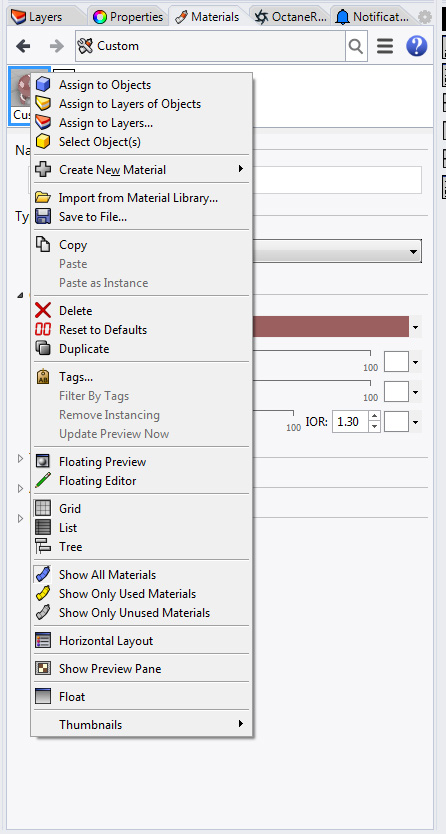

I can't find it. Am I looking for it in the wrong place?

Hi Fabrizio,
I'm assuming you're in Rhino 6 if you don't see it on the right click. If so, it's located here under the main material editor. Just click on the pull down menu and select "Octane Material" and it will change the Rhino material to an Octane material.
Also, one other note . . . if you decide to convert all materials to octane materials by right clicking in the Octane Settings tree, the only materials it will convert are ones that are used. Just FYI.

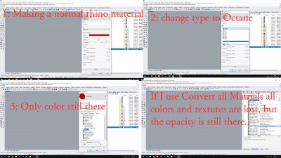

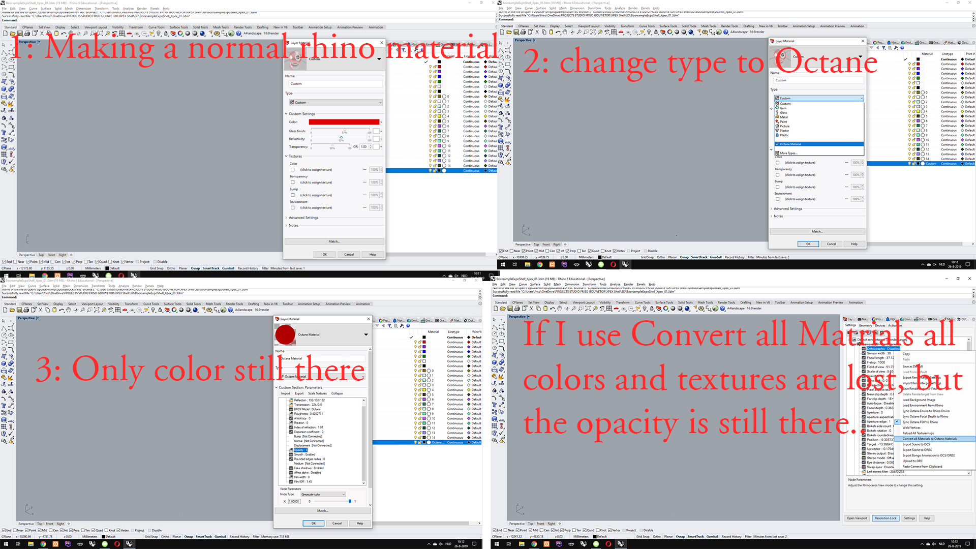

Hi there, when I try to convert a materials with the 2 options available, all the material colors and textures are lost.. is this a know issue? (transparency is converted correctly)
This is with the newest Rhino and newest Octane plugin (4.5.0.111) for Rhino 6 (Version 6 SR17 - (6.17.19218.13231, 08/06/2019).

Sure. See attached image with explanation in the image.
Rhino to Octane material problems

Hi. I just tested this, and changing the type via the material combo box, and using the Convert All Materials To Octane Materials resulted in the same material conversion, so it is working correctly for me. I notice on your screenshot there are no texturemaps, so there are no maps to convert to the Octane material. If you have a specific material which demonstrates the problem you are having, can you please send it to me and I will take a closer look.
