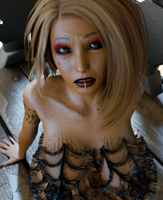

actress - normal scale (100%), octane (fast DL render, just for the test):

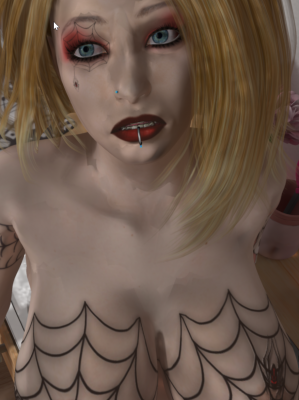

same actress at 3%, look what happens to her body tattoos and eyes:

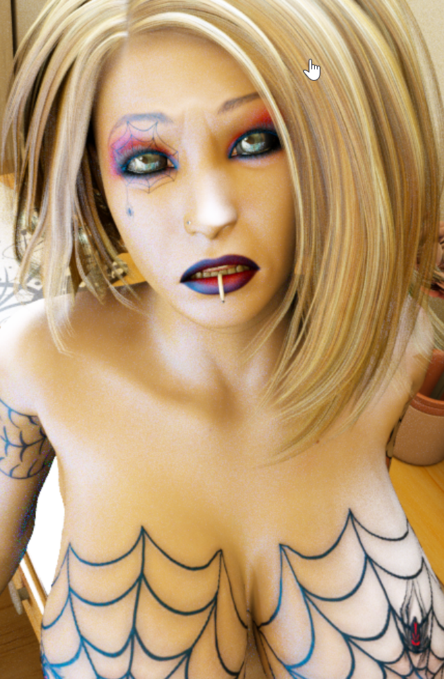

fast firefly - the eyes looks strange in octane compared to this, even in normal size:
any ideas? thanks for your help and patience, guys!

I think one of the material (my guess is displacement) is using absolute metric units, not relative units, so they are not scaled down.
Poser uses a very small scale, so be aware of anything which uses absolute units in terms of scale or distance.

wimvdb wrote:I think one of the material (my guess is displacement) is using absolute metric units, not relative units, so they are not scaled down.
I think you are correct, my friend...is there a way to fix/avoid that?
Core I7-8700K, 32RAM, GTX1080Ti, win10
wimvdb
Posts: 353
Joined: Sat Sep 22, 2012 2:03 pm
Location: Netherlands
just reduce the height of the displacement map with the same amount as the model
the model is now at 3%, so her height is 3.8 cm. If the height was 0.001 (is 0.1 cm) reduce it to 0.00003
Configuration: Windows 11 Pro, I9 12900K, 128GB, RTX 3090, P12 b1029
gsfcreator
Posts: 129
Joined: Sat Mar 31, 2018 9:45 pm
wimvdb wrote:just reduce the height of the displacement map with the same amount as the model
awesome. thanks! that solved the problem (though I fear there is a hard limit as for how small octane allows me to go...But i'll deal with that bridge when I get there).
do you have any idea regarding the eyes?

I am not really sure. Maybe you need to lower Ray-Epsilon in Kernel section. The distances are so small, that it could be self shadowing. ray-epsilon sets the treshold. In this case i think it should be lower, maybe 0, but that might give other artifacts.
The other way would be to make the entire scene larger in size. Parental all to a group and scale tje group up

wimvdb wrote:I am not really sure. Maybe you need to lower Ray-Epsilon in Kernel section. The distances are so small, that it could be self shadowing. ray-epsilon sets the treshold. In this case i think it should be lower, maybe 0, but that might give other artifacts.
I'll try that, thanks!
regarding the enlarging the entire scene - that's what I was aiming to do in order to use "smaller" cameras :-). I just hope the up-scale will pass properly to octane!
