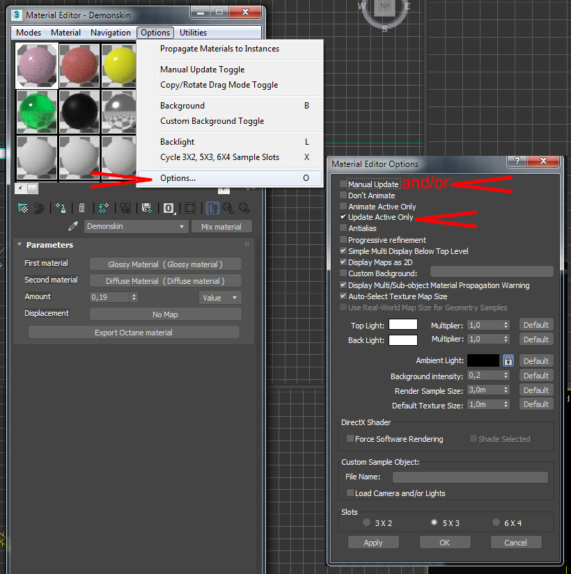

what I could recommend is to try like this.
Regards
Paride

paride4331 wrote:Hi,
Regards
Paride
it still feels slow. Opening material dialog and waiting 5-10 seconds to update. Clicking on material waiting 3-4 seconds for it to show settings, going through sub materials like mix same story. .I am using old fashion compact material i9-7900x, nvme and titan Xp I thought this should fly through

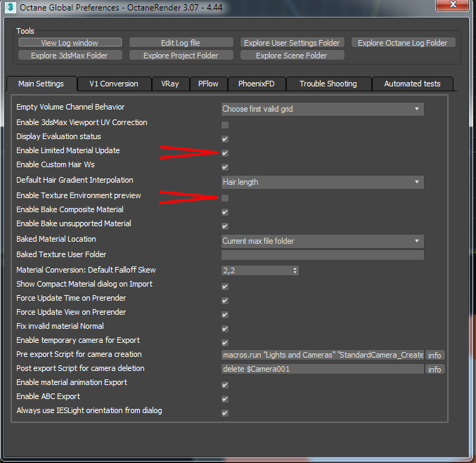

Hi guys,
I'm sorry about material editor issue, because it does not seem to happen in my case.
could you try this?:
1) connect your less performing graphics card to monitors, then 3dsMax> Render> Render Setup> Devide (tab)> inactivate that graphics card and apply.
2) try like in the screenshot.
Get back to you if anything changes, I would like to better understand this issue.
Regards
Paride

paride4331 wrote:Hi guys,
Regards
Paride

Paride your suggestions.."kinda" work...but now we have to click in the shader for it to update...and as soon as we do that..slow update

Hi Nildoe,
sure your right, my suggestion was not a workaround, but an attempt to understand what could cause this issue,
Coilbook shows issues using Multi/Sub-Object; is that issue with Multi/Sub-Object for you too?
Regards
Paride
