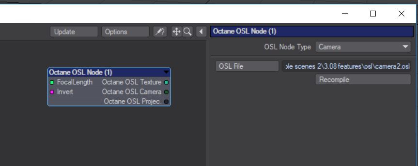

juanjgon
Posts: 8867
Location: Spain
In theory, you should be able to use this OSL camera code loading it in the LightWave plugin OSL node configured as Camera node type, as you can see in the attached image. Be aware that currently any string parameter must be hard coded in the OSL code because LightWave doesn't have a proper string node type yet.
Thanks,
-Juanjo
