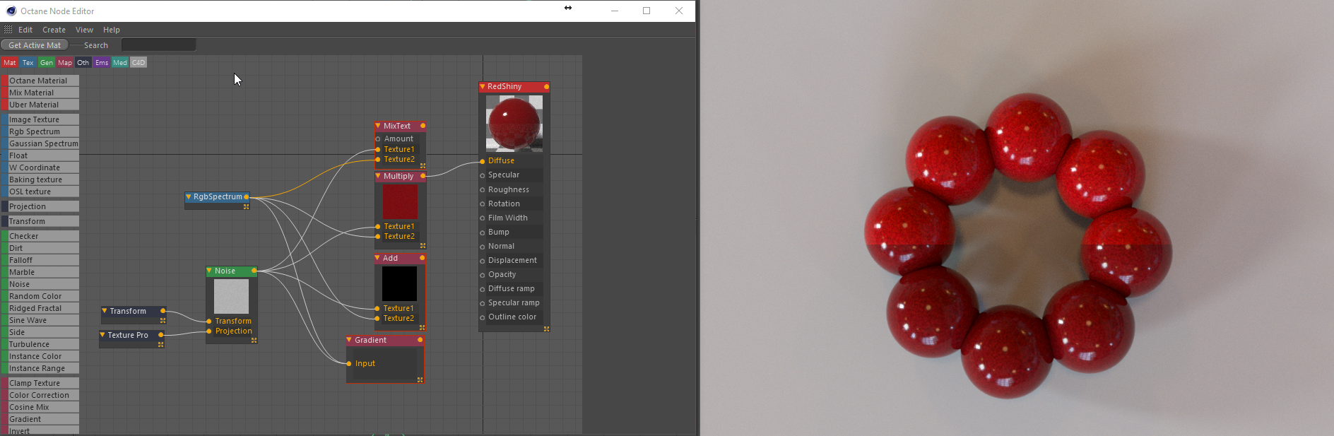

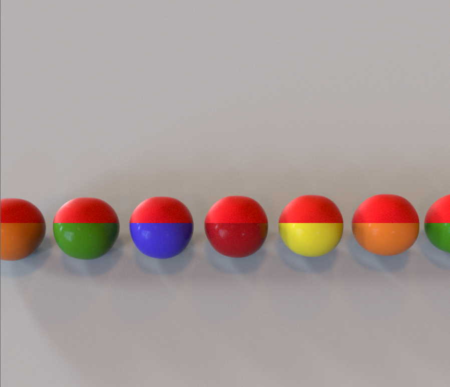

When using the following nodes in the diffuse channel of a material there is a hard line that splits the top and bottom of the live viewer where there is a color/gamma shift:
Add Node
Multiply Node
Mix Texture Node
Gradient Node
Test 1
Test 1
Test 2
Test 2
OTOY_BugReport_MultiTextureLiveViewerError.zip
Test Project
(92.78 KiB) Downloaded 198 times
This does not not show up in the final render, only the live viewer.

I tried without HDRI Link and had the same issue, even with just a single light in the scene.
Right now it only seems to be acting up when I use netrender and have one of those nodes attached.
Posts: 16068
Location: Türkiye
tobydalsgaard wrote:I tried without HDRI Link and had the same issue, even with just a single light in the scene.
Textures in netrender is broken on 3.08-test6. I'll have to move this topic because it's about a test version and no need for confusion to users. Thanks for reporting this anyway!
