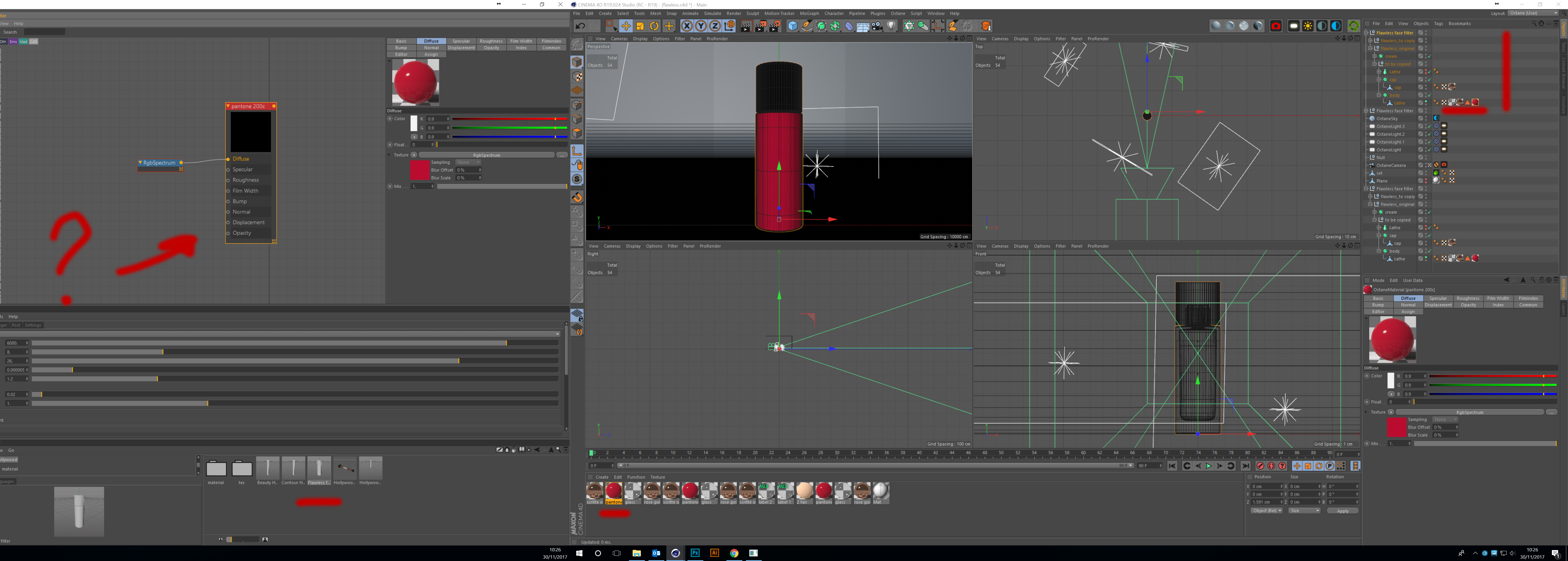

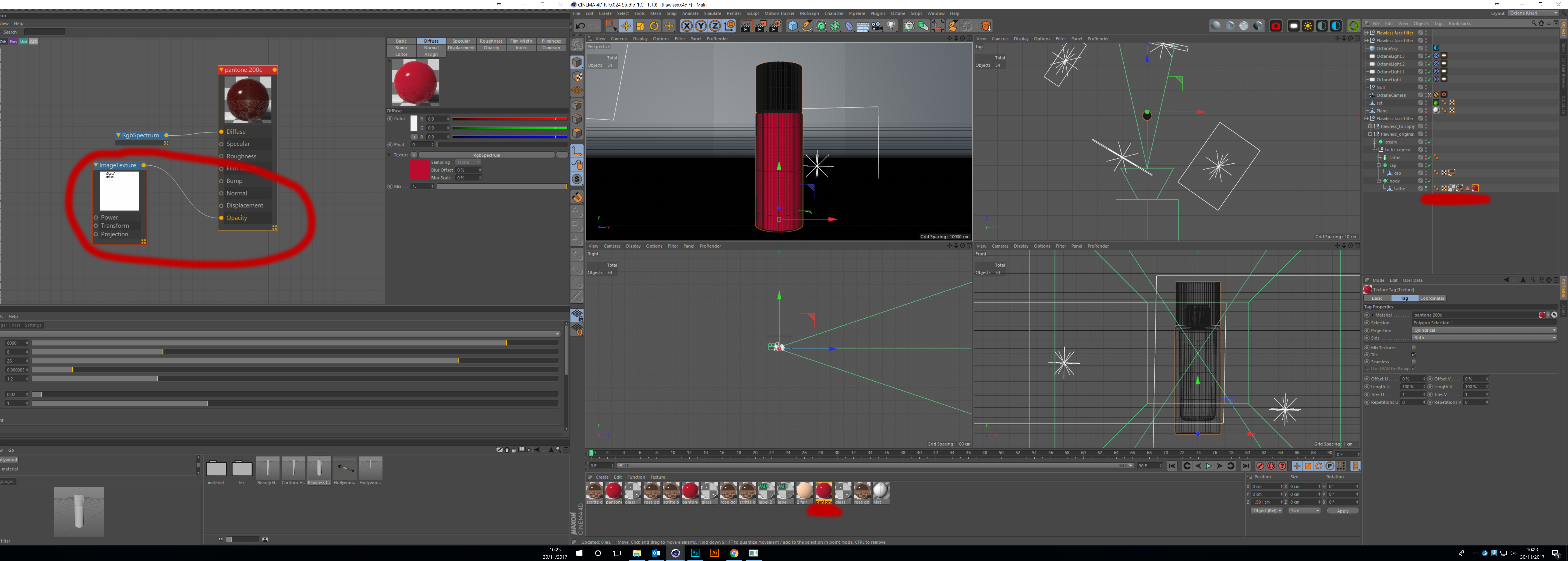

basically, i'm doing a new model to put in my master library, to be saved in the content browser.
at the moment i'm applying a glass material to a bottle, plus material with opacity mask on it to do the graphic, and it works fine.
i put my object in the content browser, but when i check the material with the opacity, the map isn't there anymore.
is this a known problem?
other thing, i tried also with the mix material, it's composed with 2 mix, glass plus 2 different material for the graphic.
the preview works fine but when i do the content browser thing, and i choose it to use the object, i loose some connection and so the material
thanks for help,
lorenzo

hi, didn't you ever find a solution to this please? having the same issue

did you tried with the new Blend material of 3.08, instead of the Mix material?
ciao Beppe
Posts: 16068
Location: Türkiye
Mix material is not good for Content browser. Also loosing the nodes will happen if you used a texture/material which is connected to another textures/materials too.
