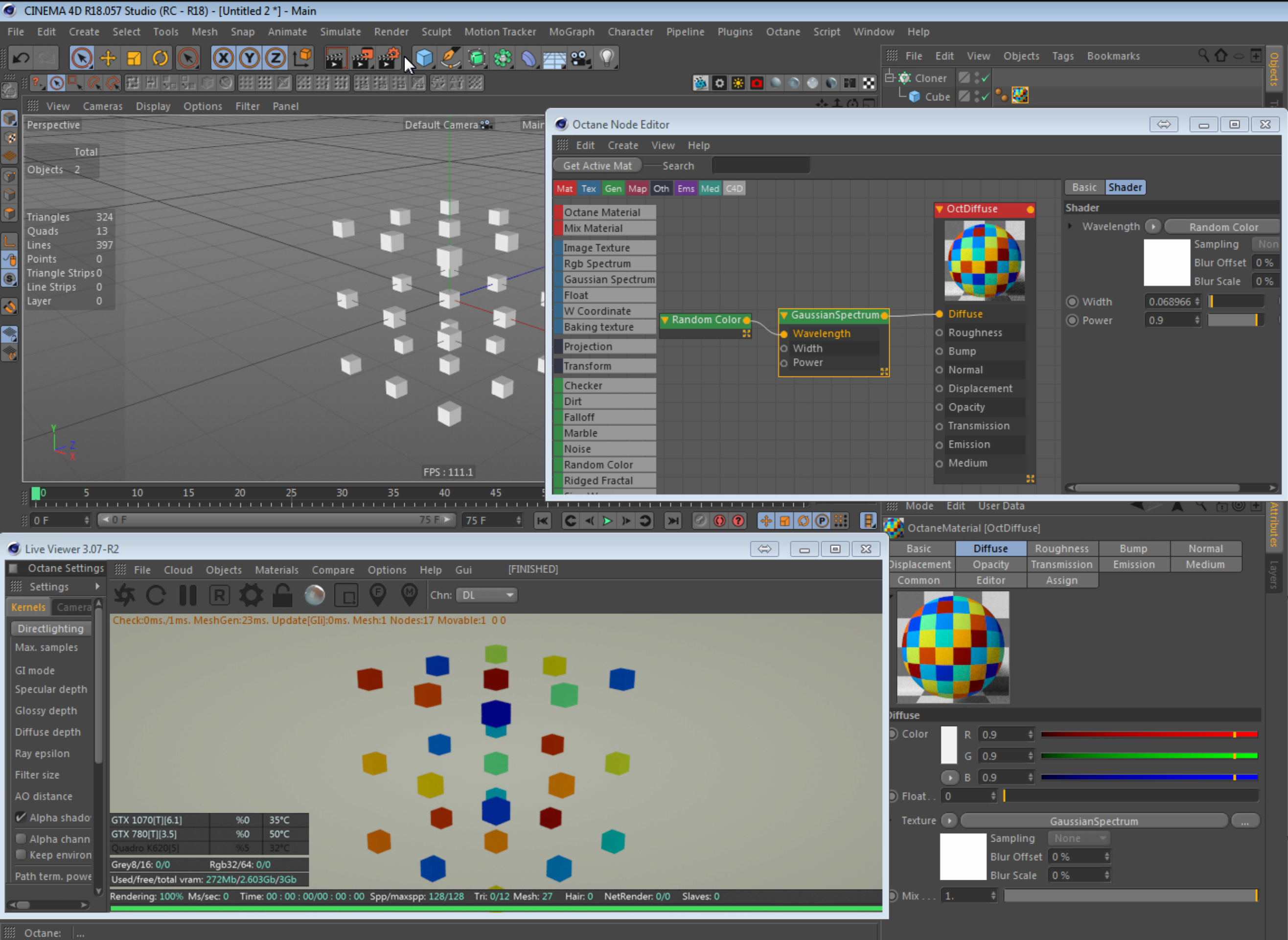

Hi thanulee,
it depends from the input texture that you need to modify, here is a simple example with a Gaussian node and the Random color texture in Wavelength: You can mix it with your texture in different mode.
ciao beppe

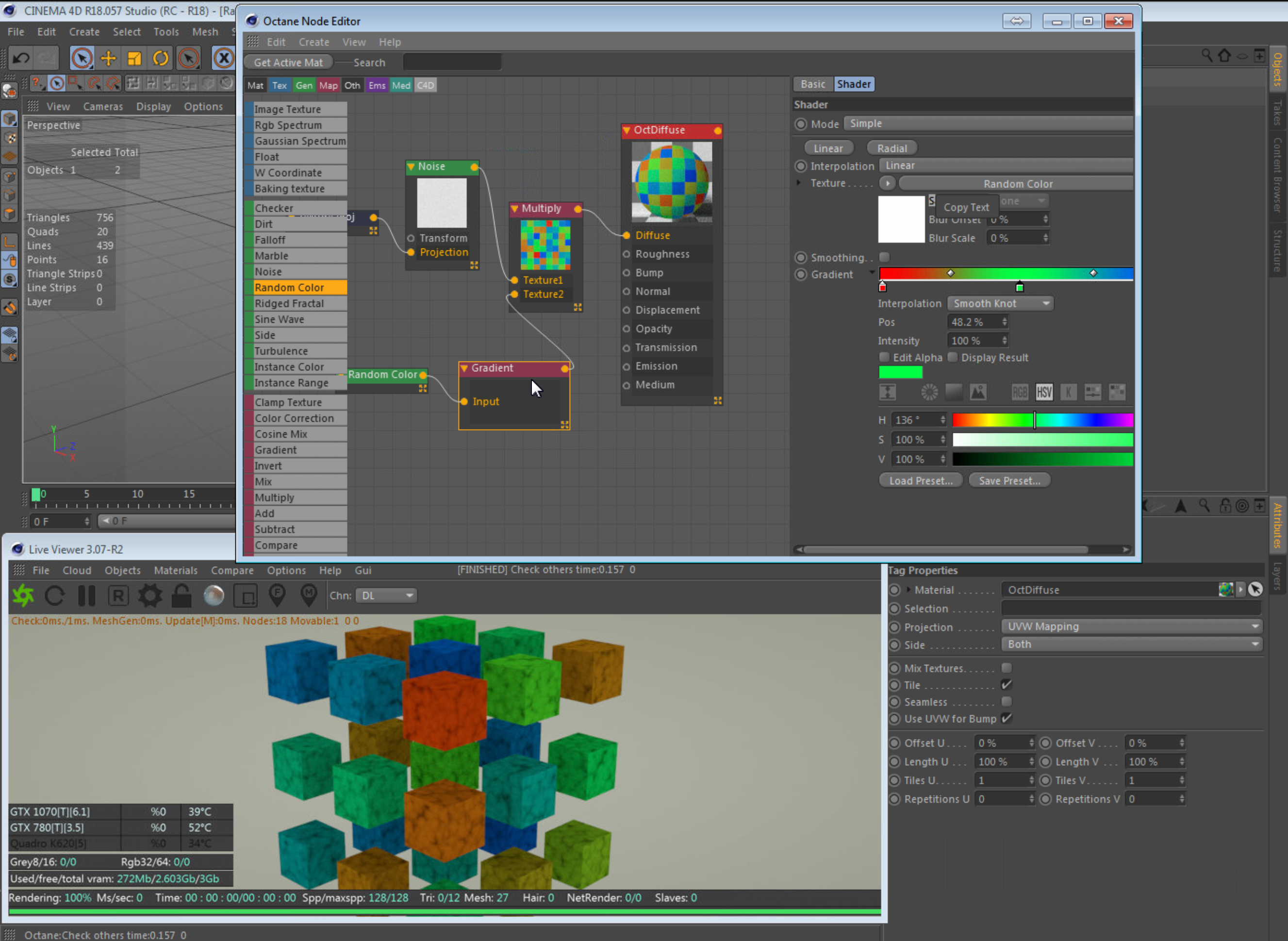

Hi thanulee,
the Gaussian node is just an example, but you can use the Random color node in the Texture slot of a Gradient node and use whatever color/texture you want, and add to your base texture in Add, Substract, Multiply ecc mode, in anykind of pin: ciao beppe
