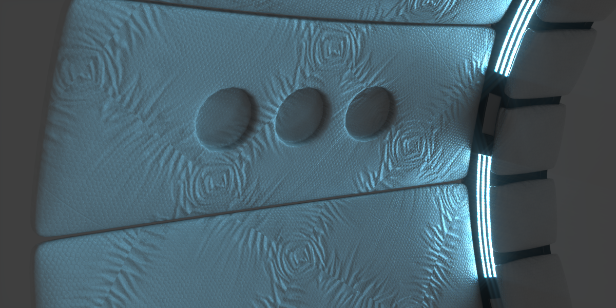

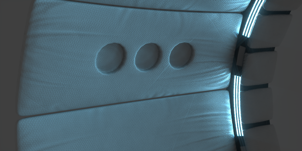

I have a problem in Standalone with generated uvset from Modo saving orbx file.
uvset MODO
uvset MODO
uvset STANDALONE
uvset STANDALONE
I use last Standalone release and last version of Modo Plugin
Here scene files:

Hi Marco. What version of the plugin are you using pls? What process did you use to export from Modo to ORBX?

Hi Paul,
my version is 3.07.0.125
My process is:
- open octanerender viewport
- save to ocs or orbx format
thanks

Thanks for providing that scene. I think this is happening because the OBJ file format that is used to save the geometry in the scene does not support multiple UV sets. You can instead set the Scene->Current Range end frame to 1 and use the octane.saveAnimation command, which will save the geometry to ABC rather than OBJ format, and it will render correctly in Octane Standalone.

ok, done.
uvset work properly with generated abc by script, now. Thanks Paul!
