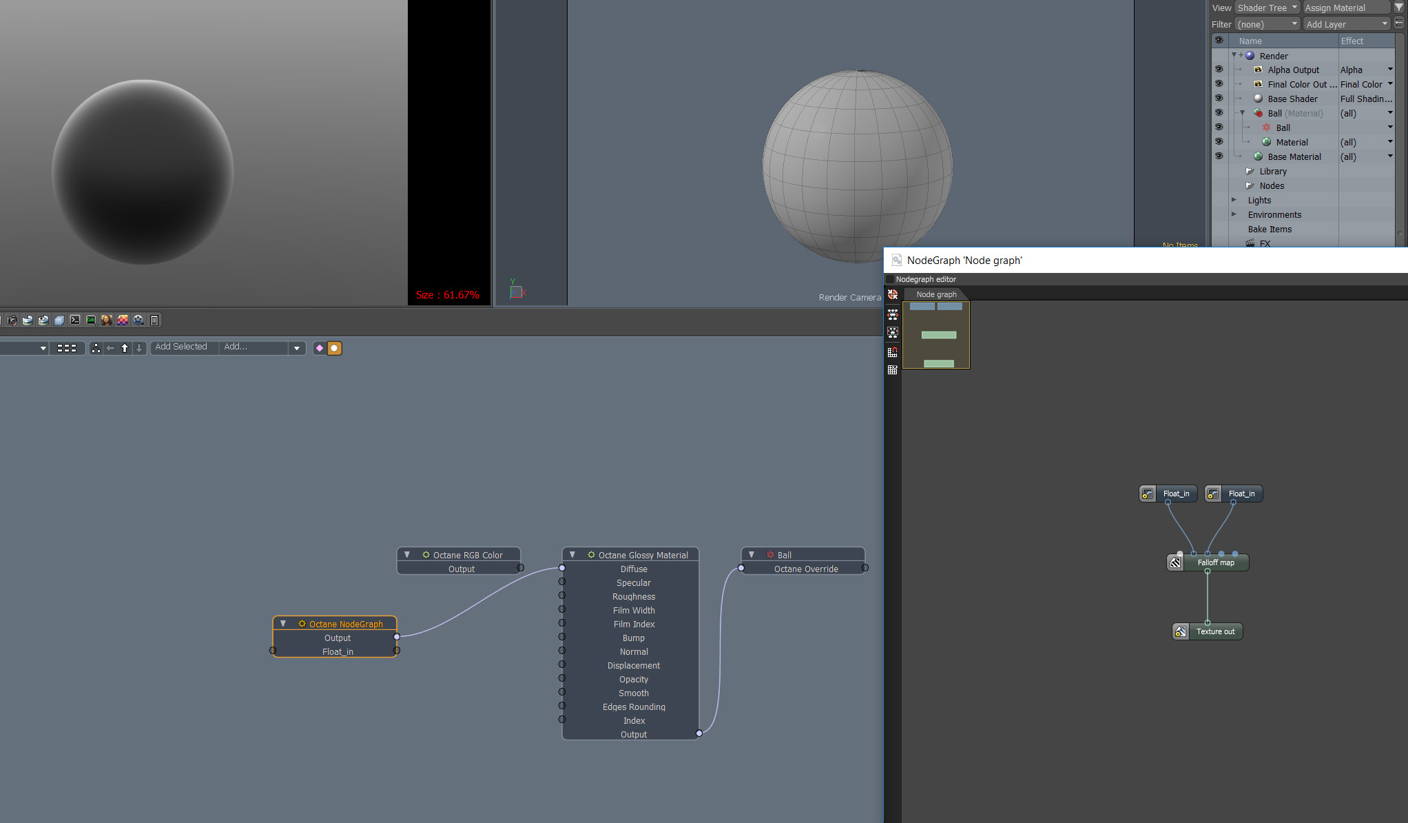

But i want to input multiple values of the same kind. So if you add another Float Input it won't appear in the Nodegraphnode. Is it possible to change this?
face_off
Posts: 15799
Location: Adelaide, Australia
Try renaming one of the float input nodes in the nodegraph. Duplicate channel names are not allowed on Modo Schematic nodes.

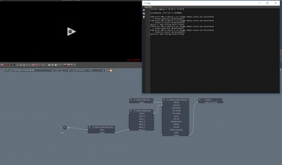

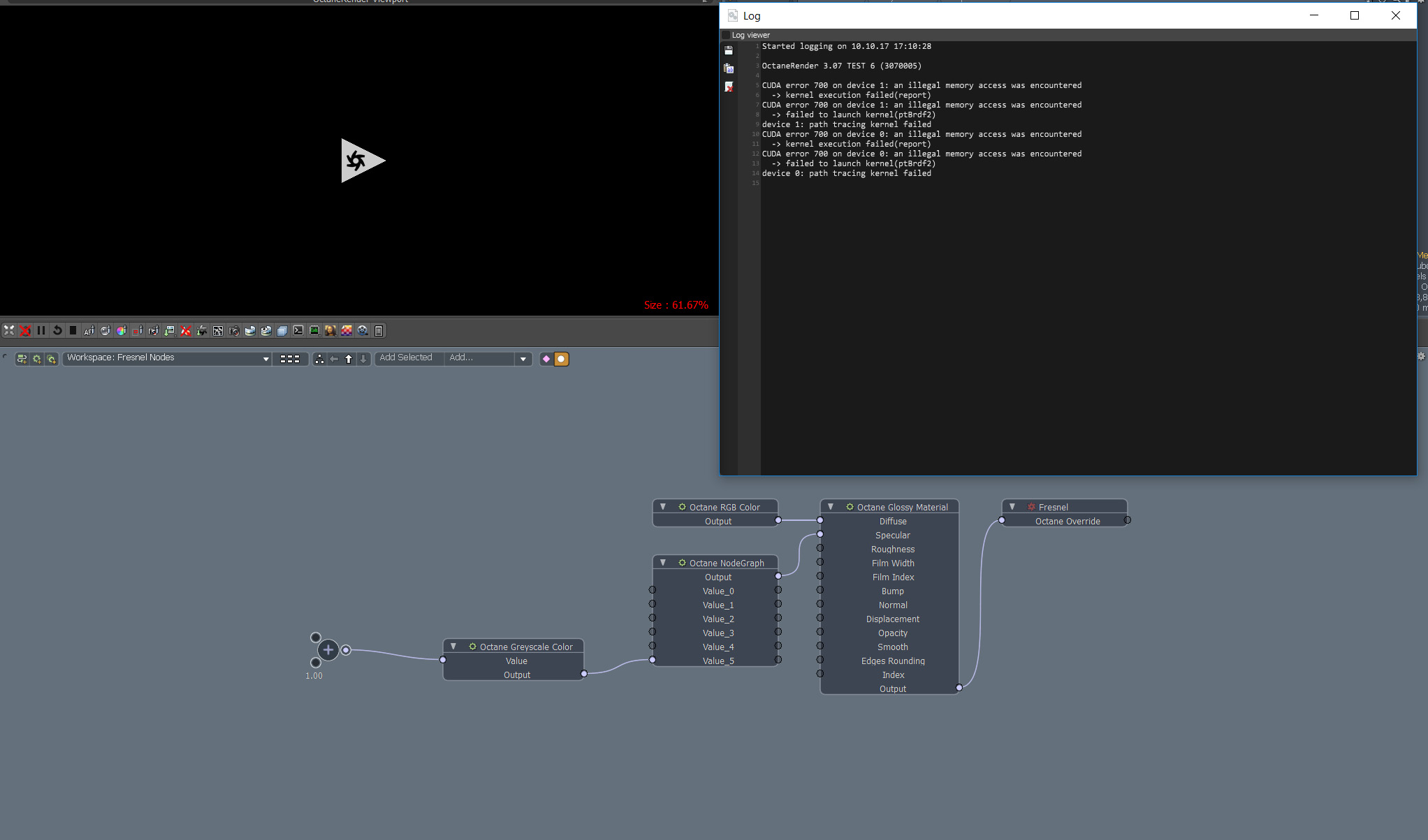

Next Problem is I get a CUDA Error 700...
face_off
Posts: 15799
Can you send me that scene pls? I cannot tell from the screenshot what is in the nodegraph node.

face_off
Posts: 15799
This is an Octane error - which I have now reported to Otoy. Appears to be related to overlapping gradient values.
