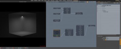

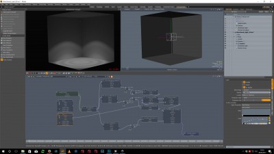

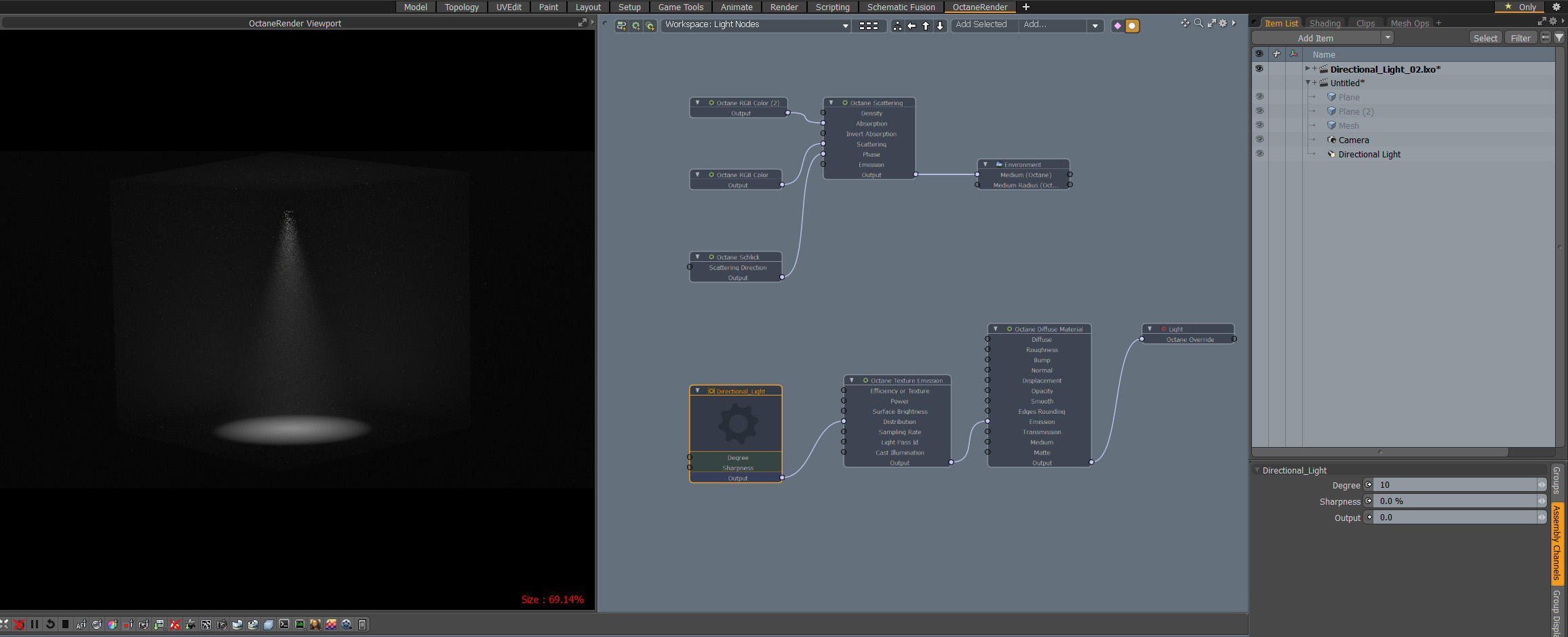

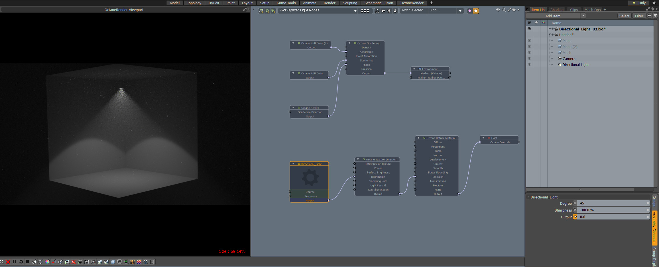

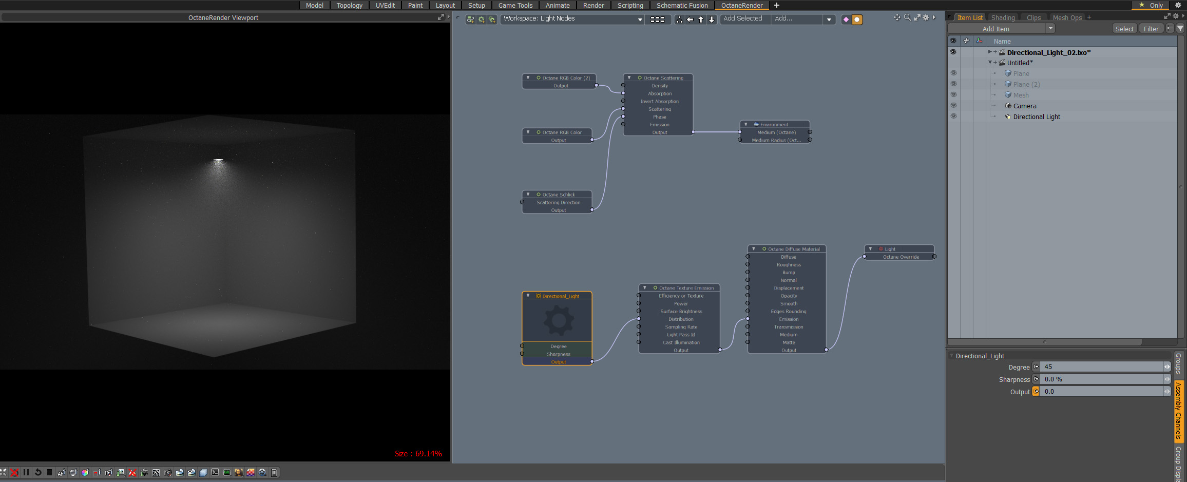

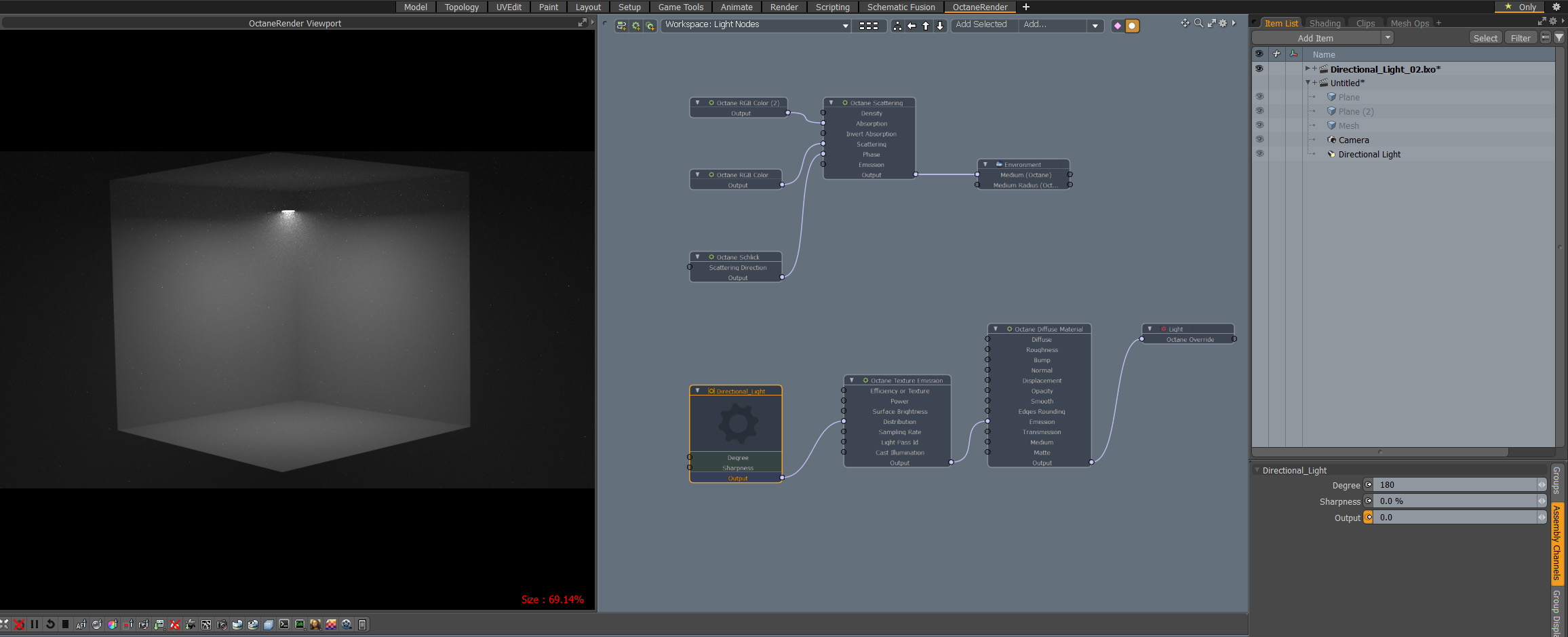

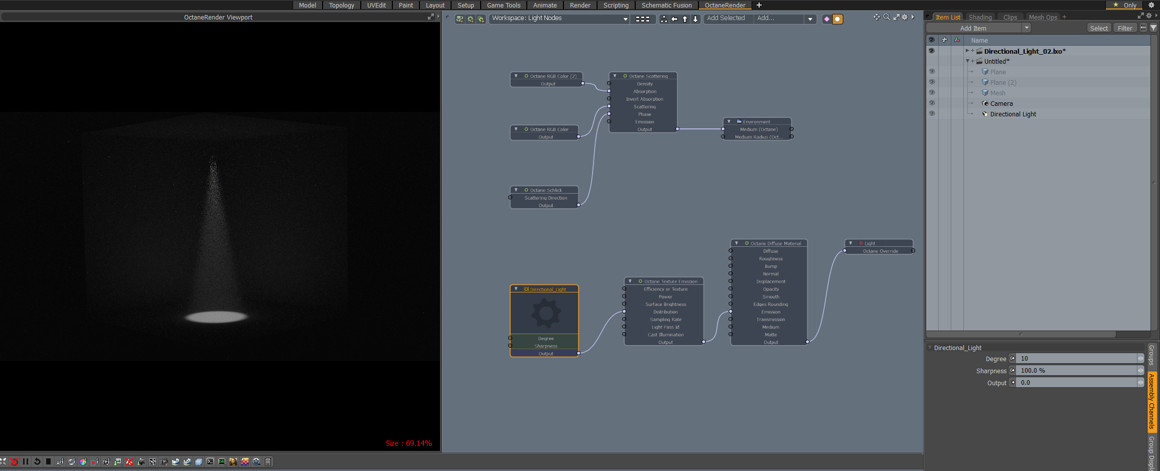

Hey there,
so i made a little assembly. You can Plug it in the Distribution Slot of the EmissionNode and control the Angle and the Sharpness of the emitted Light:
I'm very courious about your Opinion. I think it works very well and could be added to the AreaLight Item or could even be used to make a Spotlight item.
PS: I tried it also in the 3.07 Testversion and it results in an error. The last Stable version works fine.

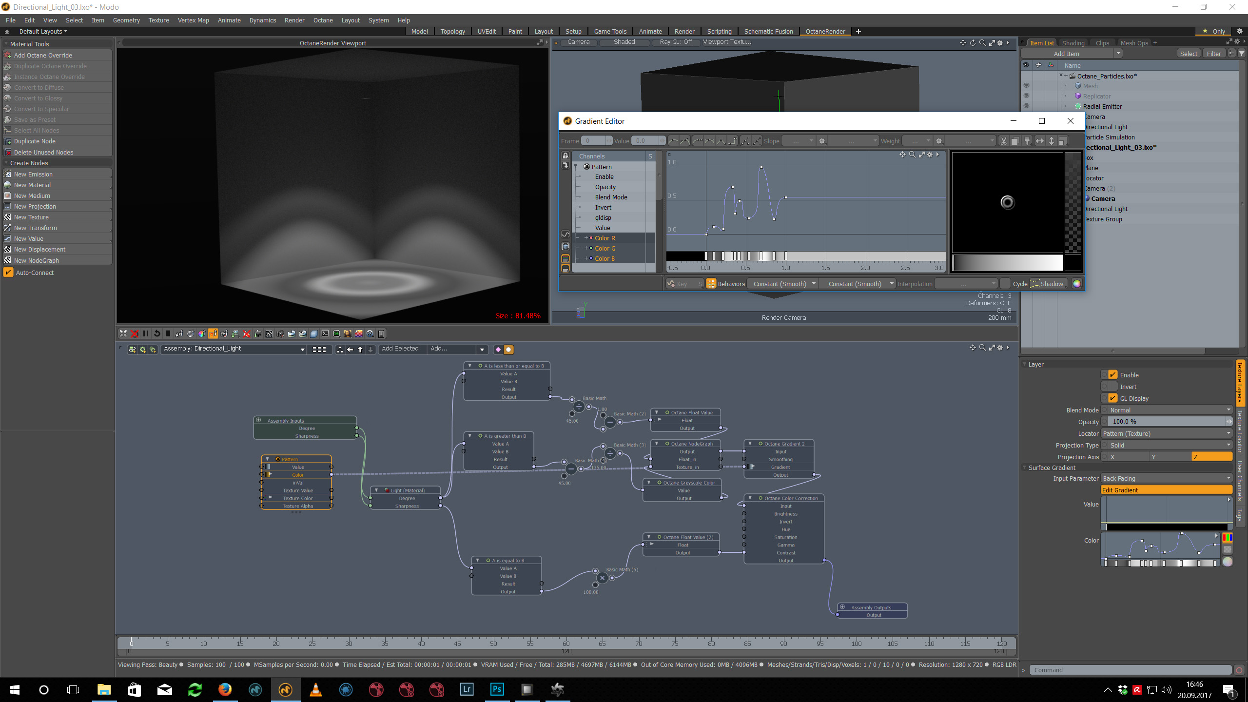

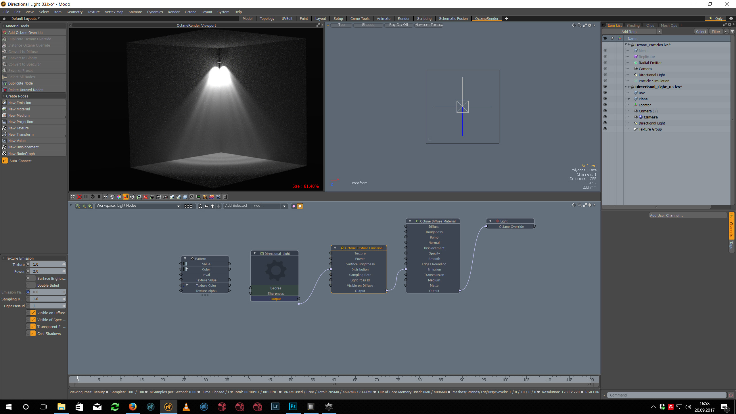

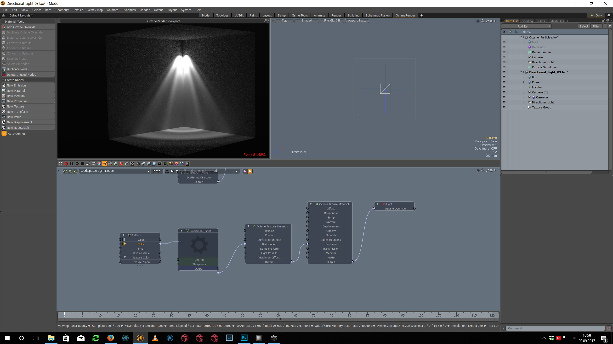

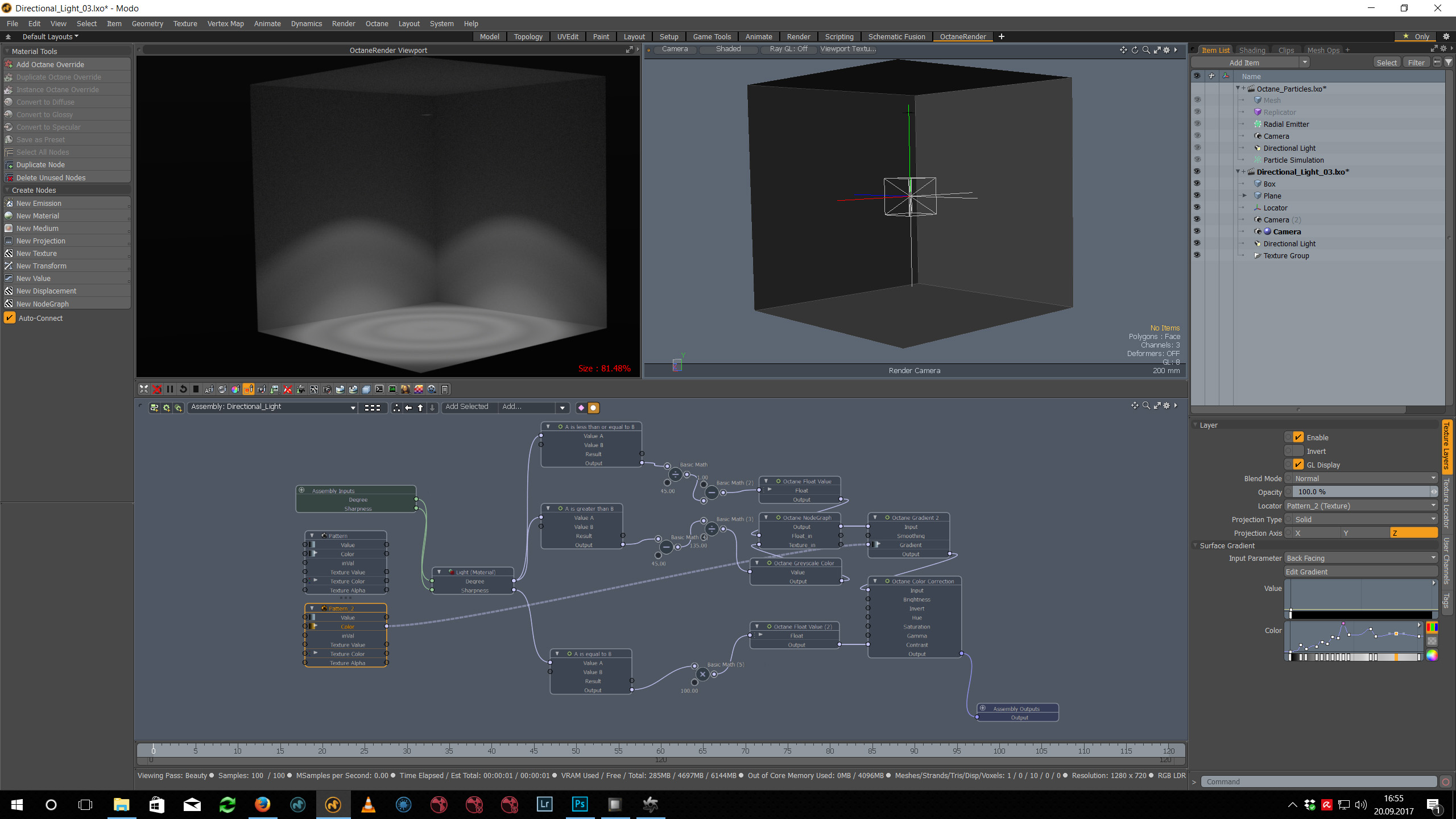

I had another idea to enhance the Spotlight even further. In the Screenshots you see a Gradient which controls the Pattern of the Spotlight. I want to add this to the assembly but i can't expose the Gradient to the Assembly. Is there a way to do this?
What do you think?

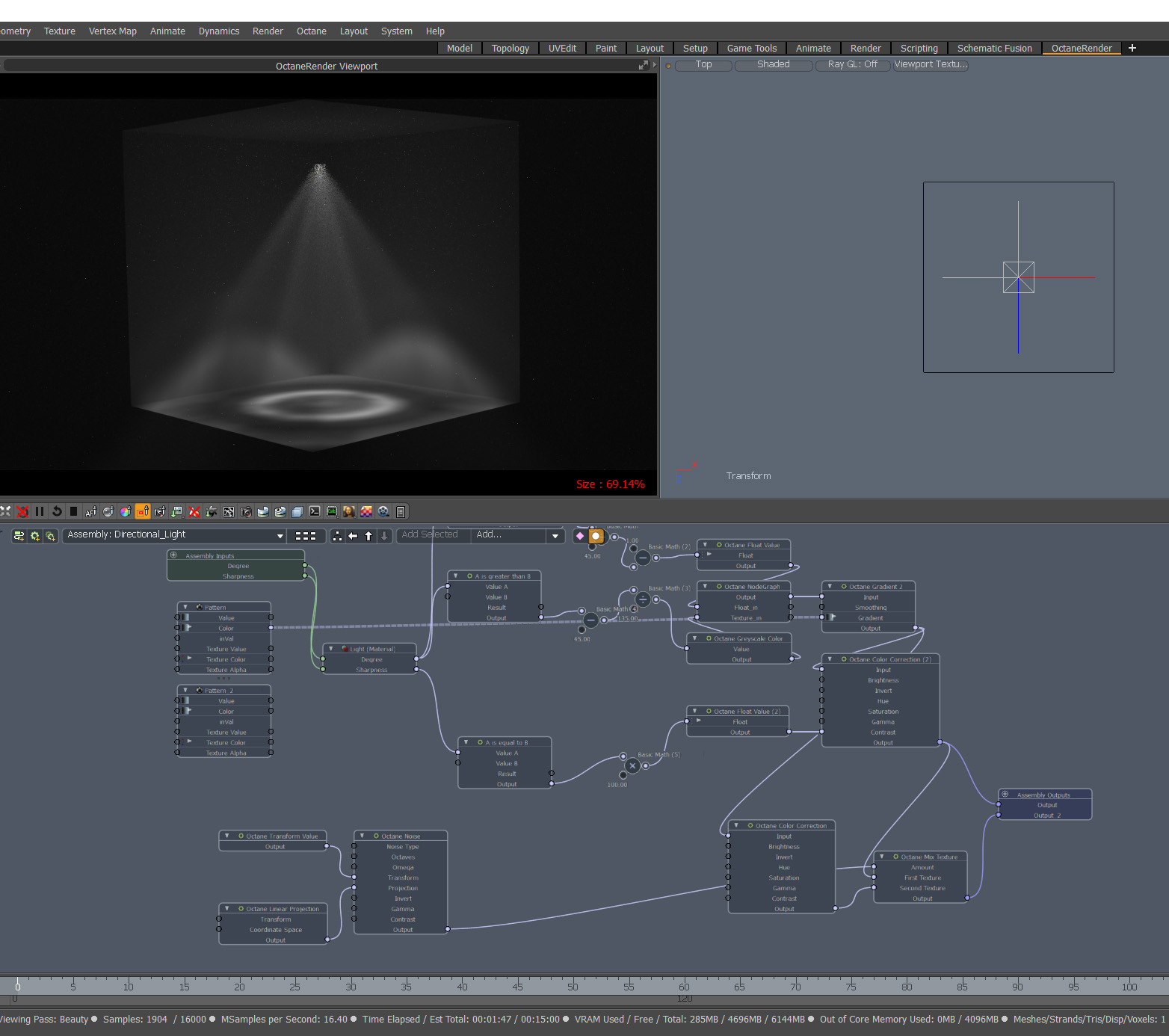

In addition it would also be possible to mix this with Textures to get even more variation:
face_off
Posts: 15799
Location: Adelaide, Australia
I understand that a gradient cannot be plugged into an Assembly in Modo, so what you are trying to do may not work.
Paul
