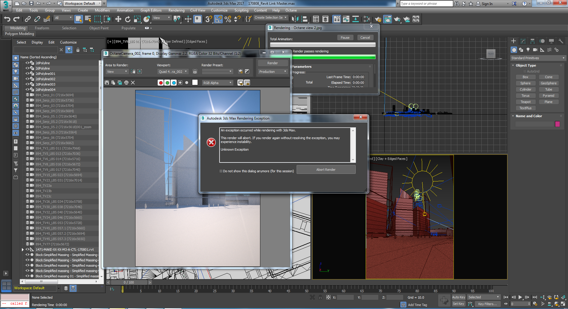

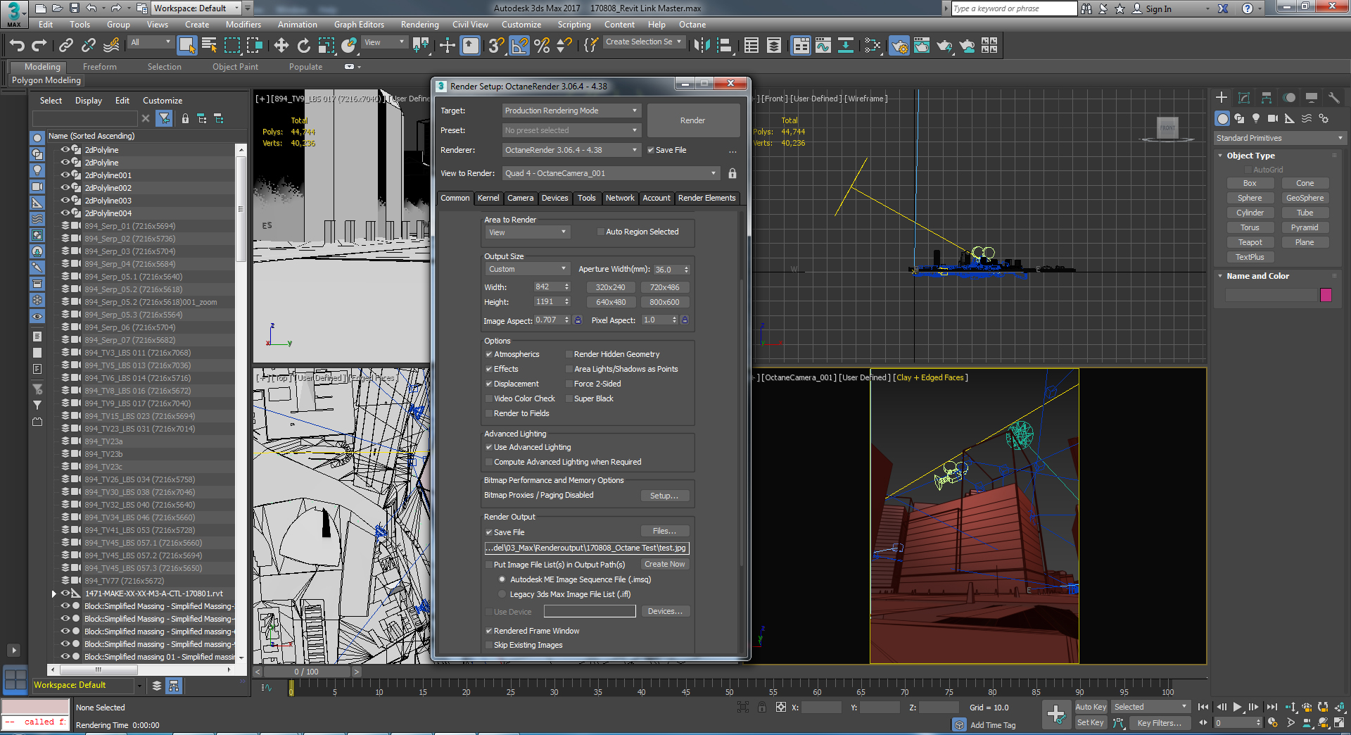

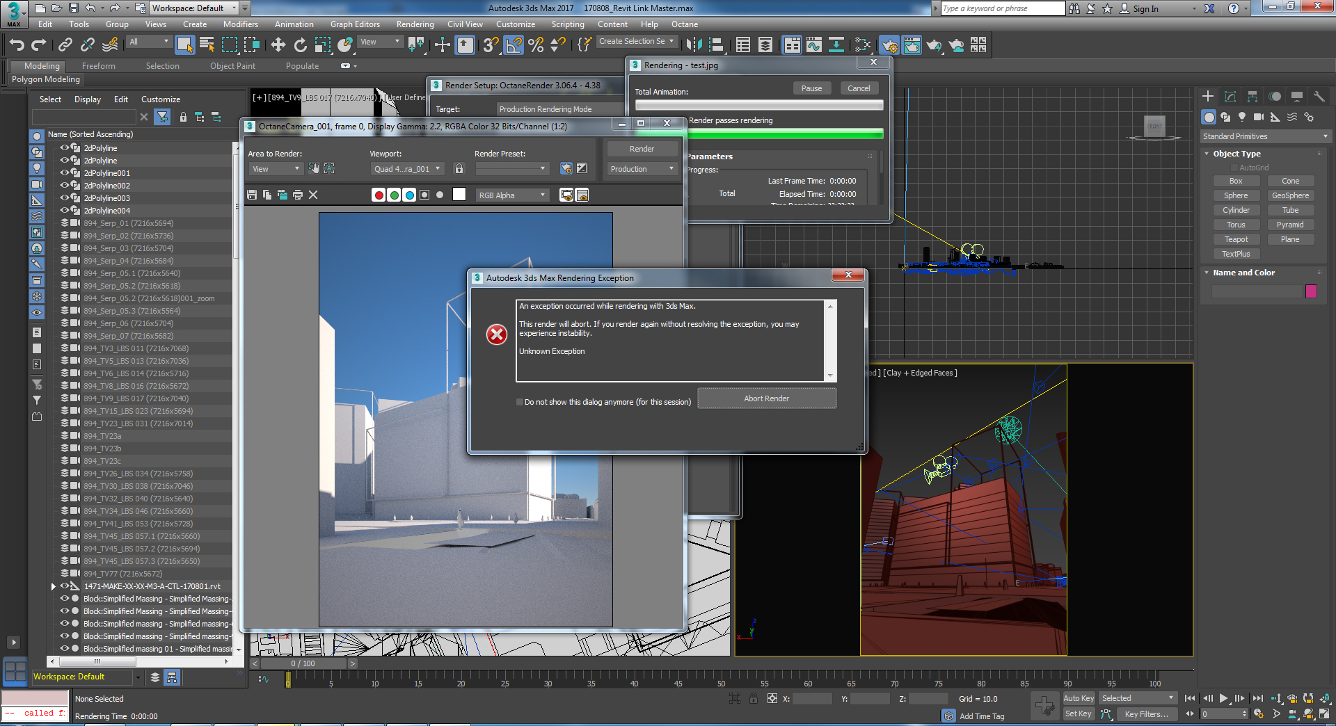

It appears that the problem is therefore with my 3dsMax file. In fact Octane fails to save to any output folder even with a single standard render. The only way I can save a render is by opening the OctaneRender viewport and manually saving.
Please see screenshots attached of the error messages I receive.

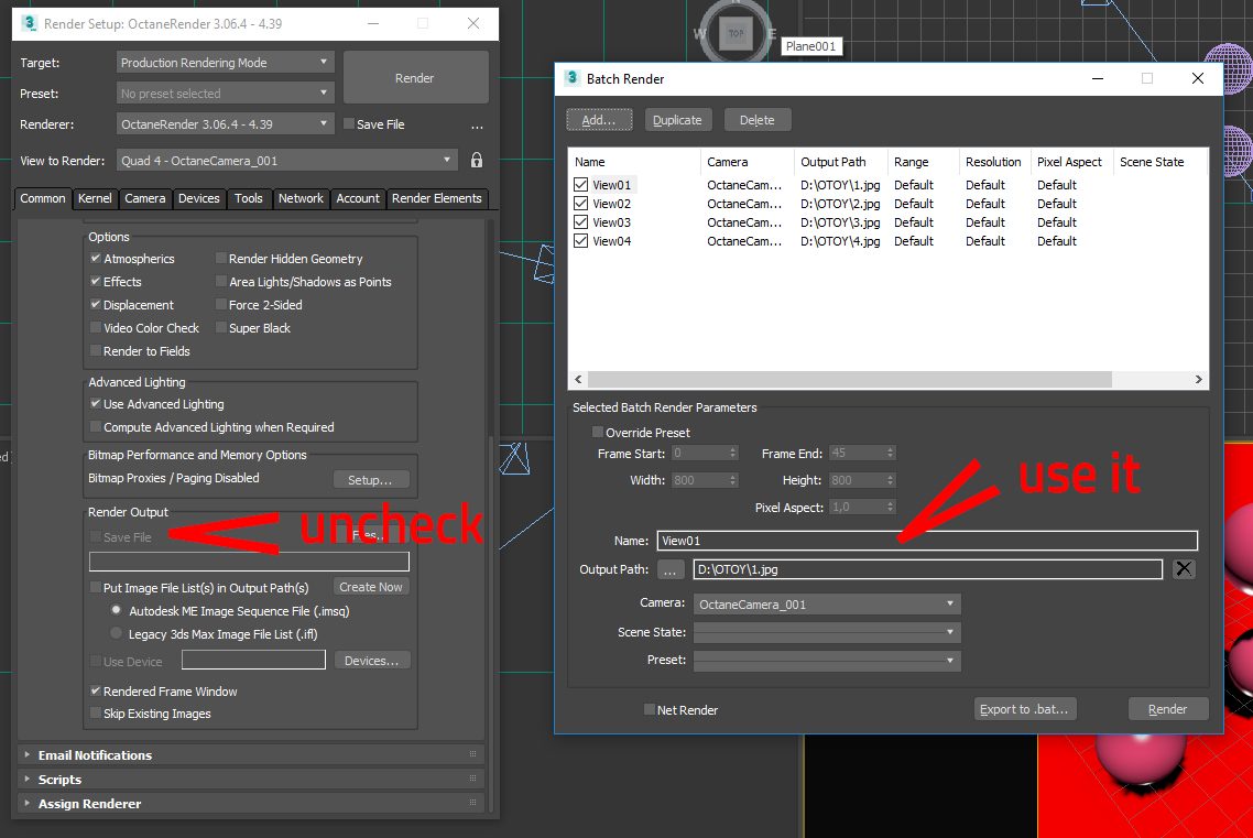

Hi princedragoncok,
Try using batch render setting save path file as in screeshot.
Regards
