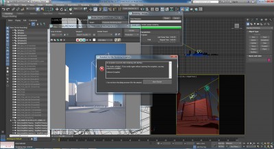

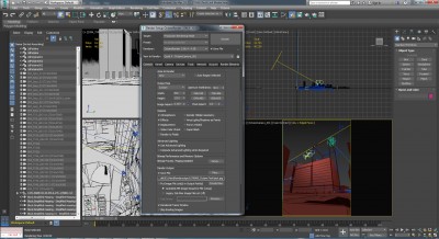

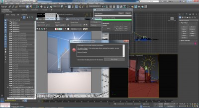

Thanks for the replies. I tested both the script above and the batch test file.
The batch test file worked, it rendered and saved to the output folder fine.
It appears that the problem is therefore with my 3dsMax file. In fact Octane fails to save to any output folder even with a single standard render. The only way I can save a render is by opening the OctaneRender viewport and manually saving.
Please see screenshots attached of the error messages I receive.
It will be no easy task to rebuild this model into a new file as it is massive and contains many xrefs and a revit link. Therefore any help with the current file would be greatly appreciated.
