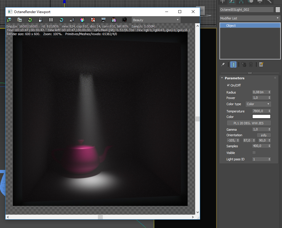

Hi Jim99,
Octane 3dsMax IES lights work exactly the same way (screenshot)
All 3dsMax Octane lights and blackbody / texture emission work with medium volume.
viewtopic.php?f=21&t=56599&p=290400&hil ... ys#p290400
Integrated medium in IES would be something like this:
viewtopic.php?f=27&t=60532&p=310174#p310174
And this does not even have in C4D for all I know.
Regards
Paride
Regards
Paride
