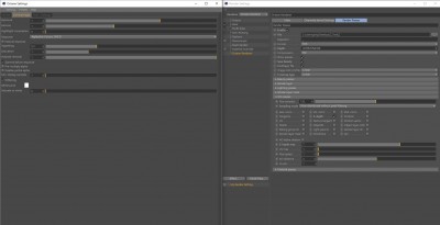

Here's my setting:

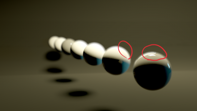

And here's the result composited in Nuke:
How to get rid of the weird edge and get the correct result?

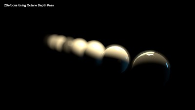

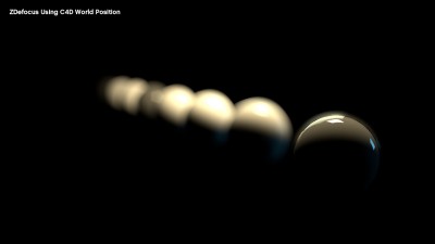

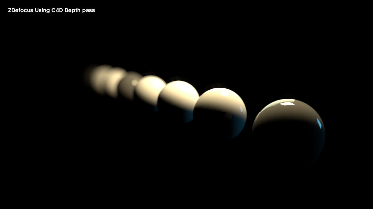

[2017/07/28 Updates]-----------------------------------------------------
Desired Effect
Any idea how to get things right in Octane?

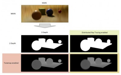

sorry, not a Nuke user, anyway, if you set the Sampling mode to "Non-distributed without pixel filtering", the Z-depth pass will not have any DOF or blurring effect, is this what you need for you Z-depth pass?
Please, have a look at this image:

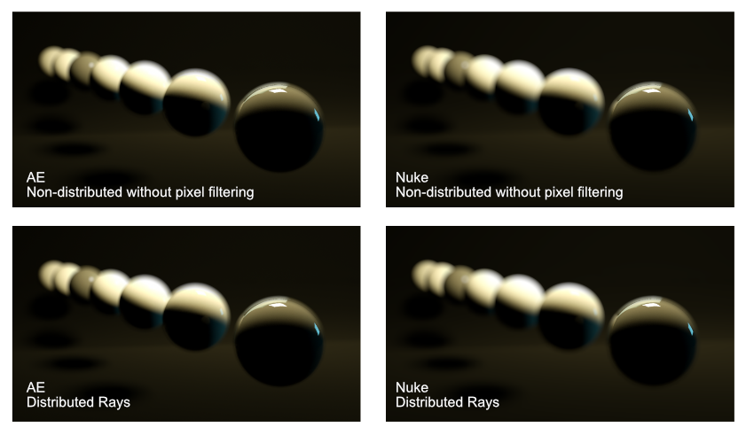

Here's some tests I just made:
I set the focus point on the closet sphere.
Notice they both have weird blur around it.
It seems nothing to do with which software for compositing.
Is it something related to filter size?
I tried to set it to 0.001 or 1, but in vain.
Would it be a bug of the newest version of Octane?

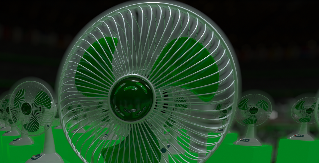

Hi
I am having the same issues. I am trying to render a grid of desk fans but the z-depth pass always makes the edges blurry. Any advice. Attached screenshot
