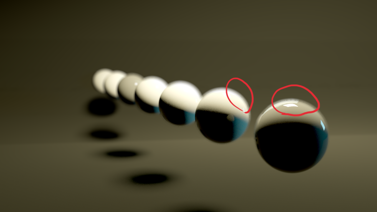

I'm using C4D R18.057 and Octane 3.06.2

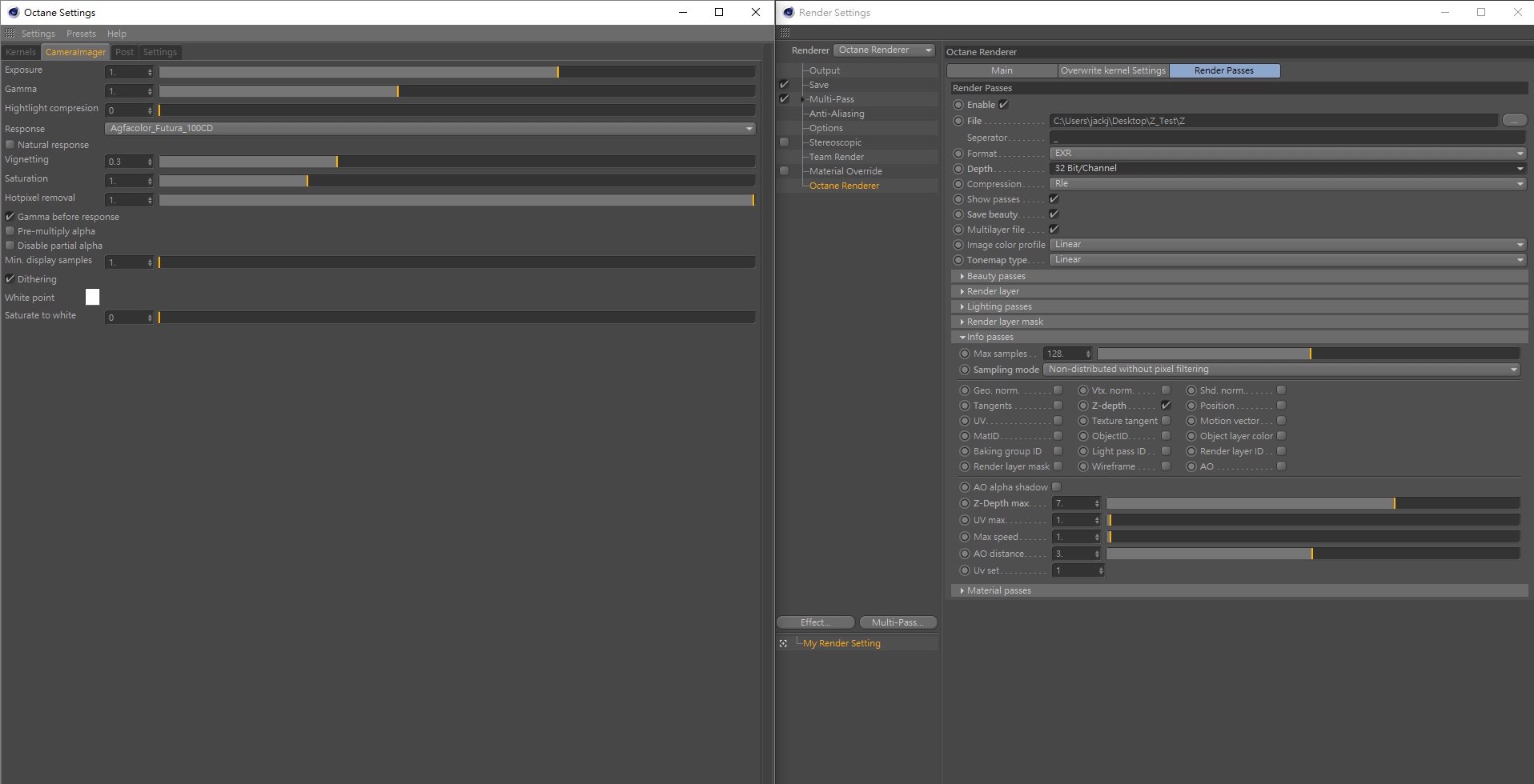

Here's my setting:
And here's the result composited in Nuke:
How to get rid of the weird edge and get the correct result?

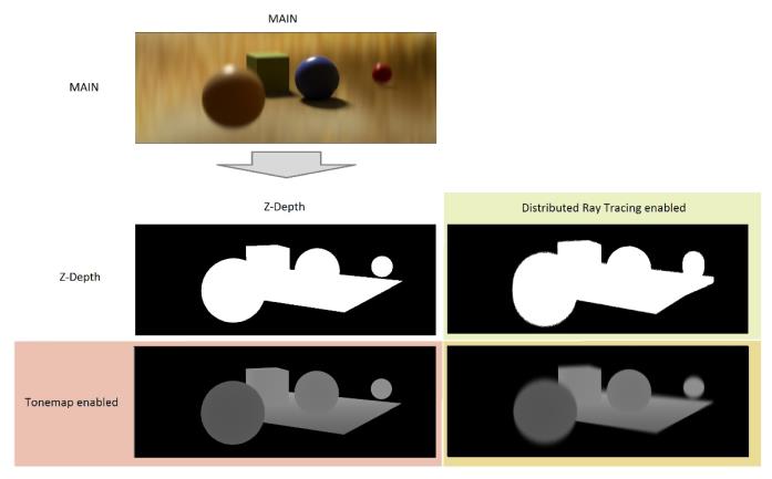

sorry, not a Nuke user, anyway, if you set the Sampling mode to "Non-distributed without pixel filtering", the Z-depth pass will not have any DOF or blurring effect, is this what you need for you Z-depth pass?
Please, have a look at this image: ciao beppe
Thanks so much for you reply.
I've set my sampling mode to Non-distributed without pixel filtering already but it still gets weird result.

Setting my focus point on the closest sphere, I get some weird blur around it.

Hi jackplus,
sorry, please try with Distributed rays option instead, in this way the DOF and the blur will be rendered with the Z-depth pass.
Please have a look at this video about Z-depth in AE:
https://vimeo.com/201203670
[vimeo]http://www.vimeo.com/201203670[/vimeo]
ciao beppe
ciao beppe

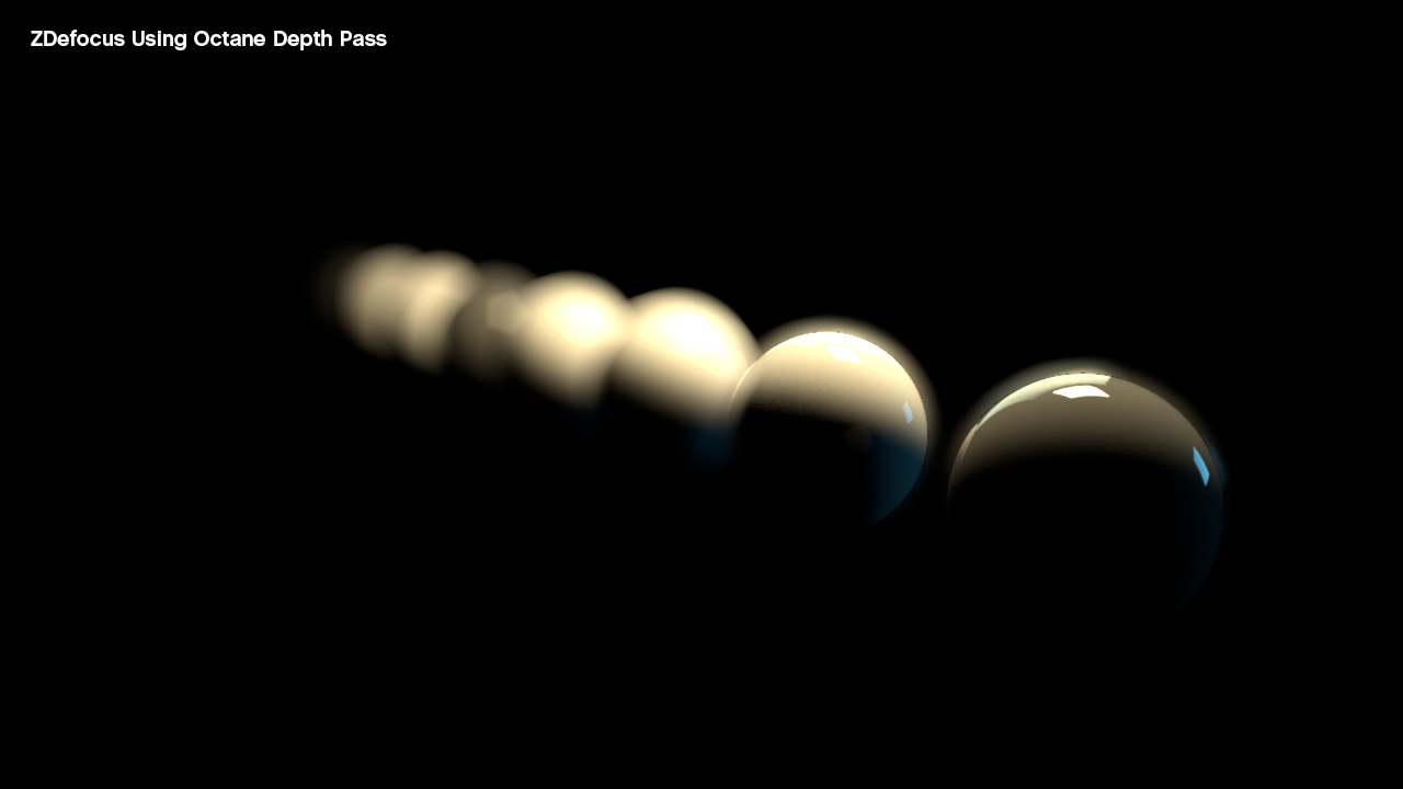

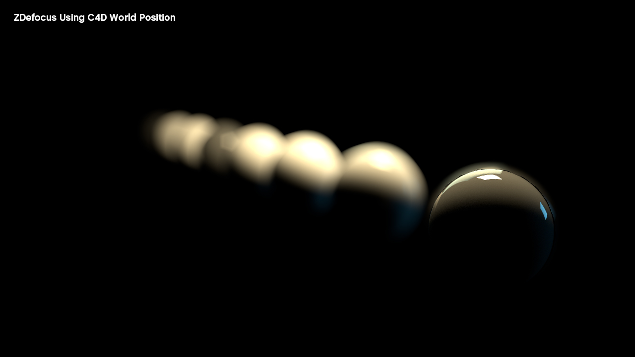

Here's some tests I just made: I set the focus point on the closet sphere.
Notice they both have weird blur around it.
It seems nothing to do with which software for compositing.
Is it something related to filter size?
I tried to set it to 0.001 or 1, but in vain.
Would it be a bug of the newest version of Octane?
