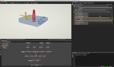

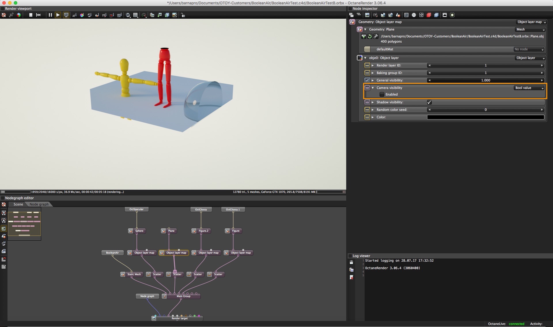

the trick is to untick the Camera visibility option in the object layer, so it will be catted by the geometry with the BooleanAir material assigned.
Here is a similar scene in .orbx format:
BooleanAirTestB.orbx
(1.97 MiB) Downloaded 218 times
ciao beppe
Posts: 10522
Hi azims,
I have just figure out to have not saved the .orbx before posting, sorry.
The following file should be more clean:
BooleanAirTestB2.orbx
(1.97 MiB) Downloaded 228 times
ciao beppe
