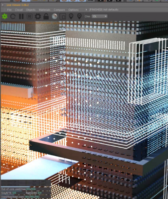

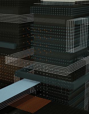

I'm seeing a totally different result in the Picture Viewer as opposed to the live viewer. Lighting is not bouncing off materials and glow is not applied either. It's totally bland and there are no reflections vs the live viewer, which is producing a perfect result.
Output from Picture Viewer, not doing what it should be doing. I am using the octane rendering in render settings
Live Viewer, doing perfectly fine.

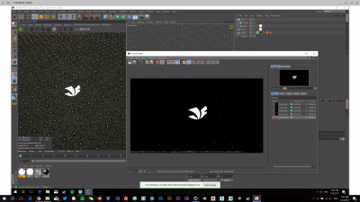

My mistake. Here is a screenshot and project file. You might be missing an image, you can take that off from the "logo" material.
cover.rar
Project file, you can safely ignore the missing image.
(101.53 KiB) Downloaded 135 times
Live vs Picture Viewer

You need object tag on boolean geometry. It's propably due lack of detection emissive material on this kind of mesh. LV is having "all objects movable=ON" and emission amount will be different between static vs. movable geometries.
Btw why don't you use Octane materials and textures? It's not a good and accurate way to use C4D types. And are you using "Global Illumination" effect due testing purposes?
