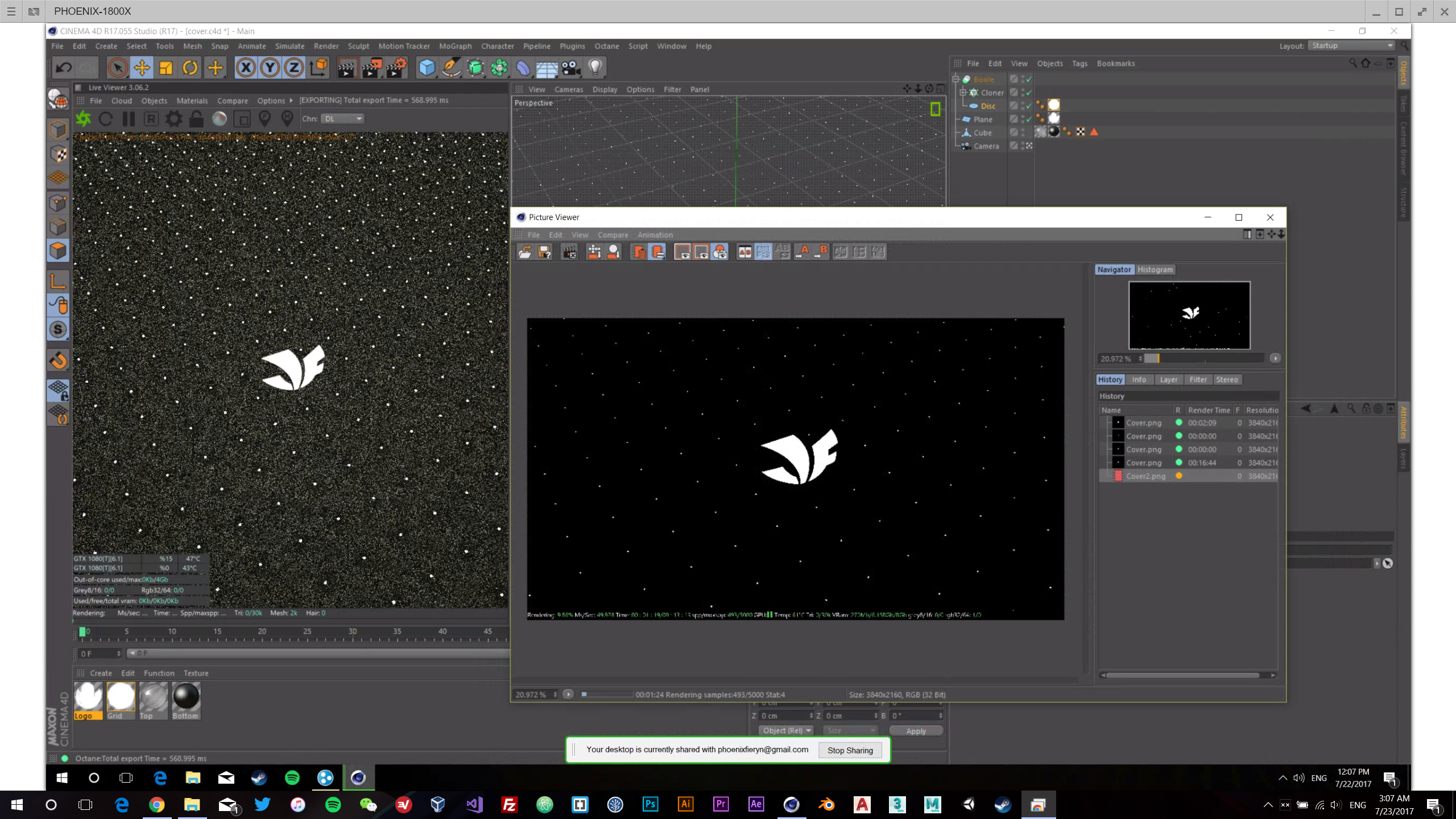

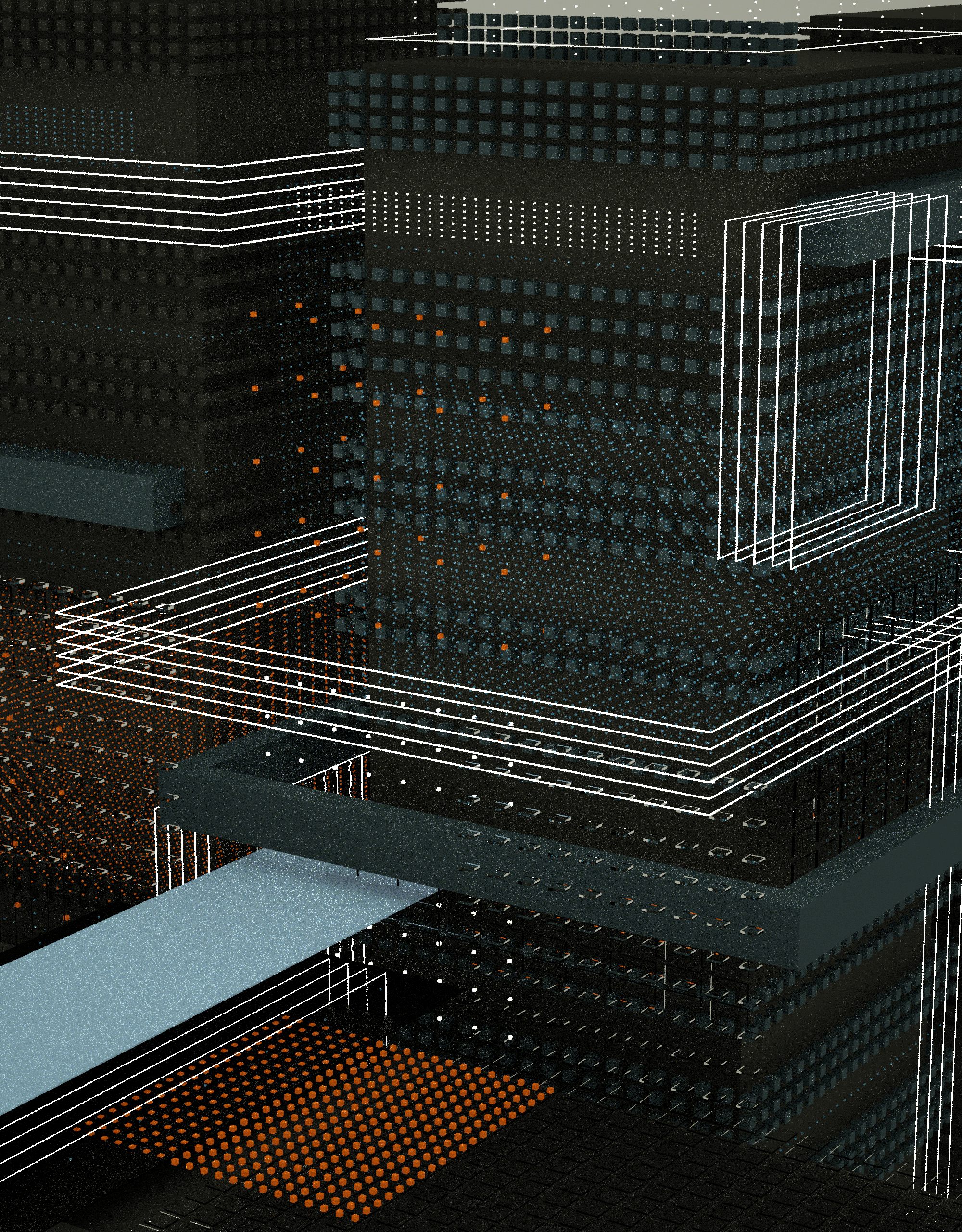

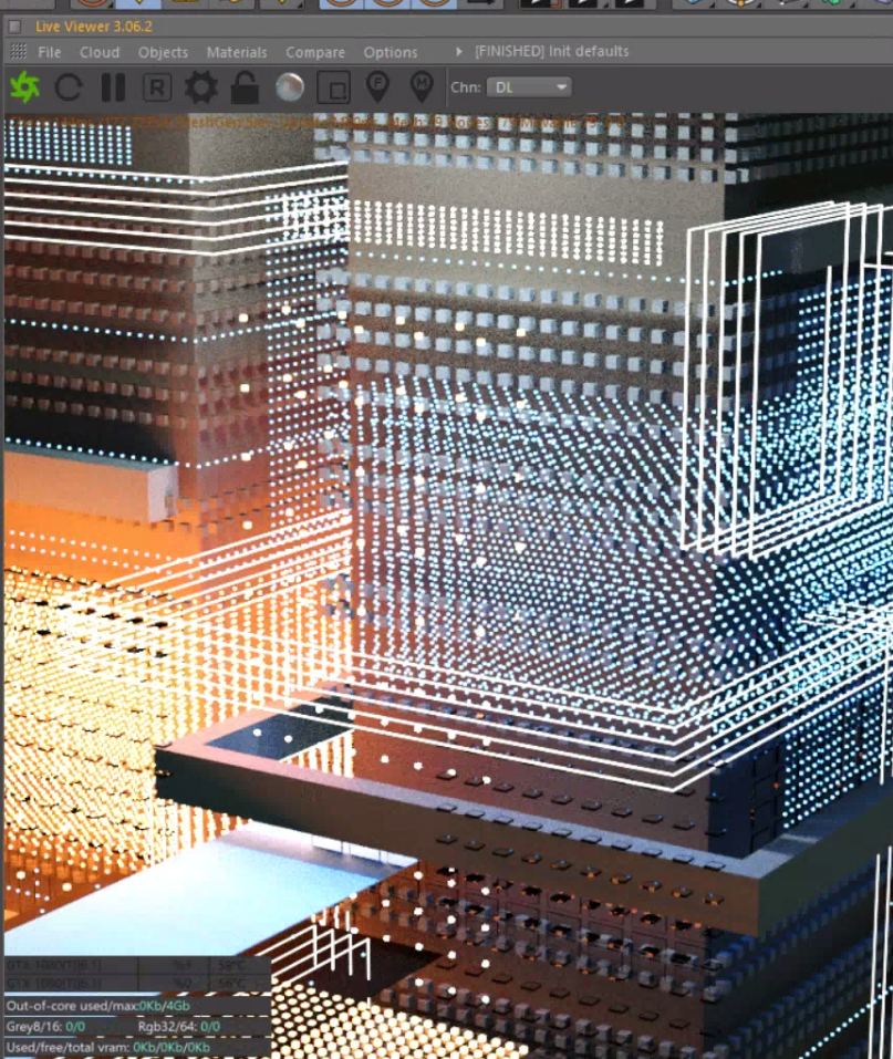

I'm seeing a totally different result in the Picture Viewer as opposed to the live viewer. Lighting is not bouncing off materials and glow is not applied either. It's totally bland and there are no reflections vs the live viewer, which is producing a perfect result.

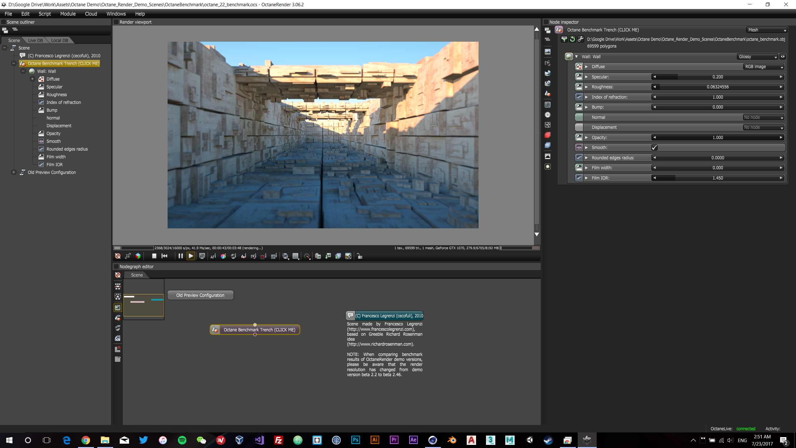

Demo scene seems to be doing just fine. It's happening on both my laptop (GTX 1070) and desktop (2x GTX 1080). Though I've been using Octane Render through C4D using that file.aoktar wrote:Could you post a sample scene?

You need object tag on boolean geometry. It's propably due lack of detection emissive material on this kind of mesh. LV is having "all objects movable=ON" and emission amount will be different between static vs. movable geometries.
Btw why don't you use Octane materials and textures? It's not a good and accurate way to use C4D types. And are you using "Global Illumination" effect due testing purposes?
