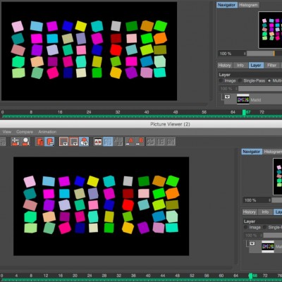

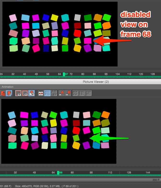

Looks like you're right.
I made a change to that original test and disabled one of the cubes at frame 68, and some, but not all MatID colors were changed.
rendered with 3.07R2

mrpinoux wrote:Ahmet, good sir, is there a way to get a fix for this, or this is something out of your control?
Community, what do you guys do to get around this, meaning still using matID and having objects being turned on and off, troughout the c4d plugin?
Thanks!
It looks like a core behavior as you can see my test in Standalone.
