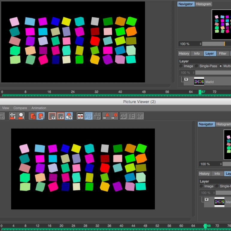

Looks like you're right.mrpinoux wrote:Happens to me. Im in the middle of a project so I don't have time to do tests, but my guess, turning on and off objects in the manager during animation cause the renderer to reassign color ID?
I made a change to that original test and disabled one of the cubes at frame 68, and some, but not all MatID colors were changed.
